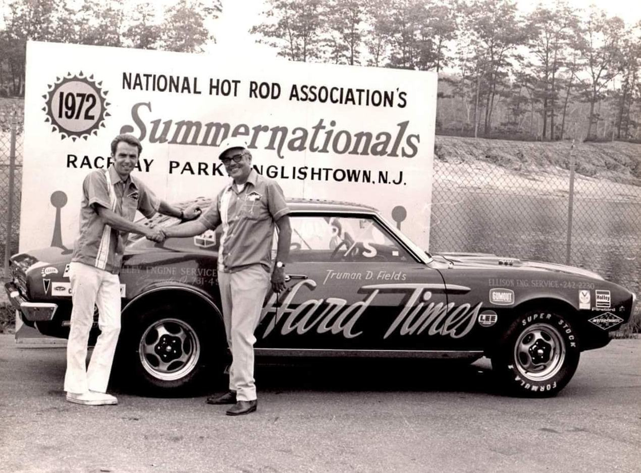

BUT, I do have at least 1 pic of Truman Fields '68 RA2 Bird marked A/S. But, that was in '72, which was one of the weird pure stock type years. So, I reckin it all depends on what year we are talkin about.
Name:	1 - '67 Myrtle Motors .jpg
ID:	61046   Click image for larger version
Name:	2 - '72 A-S Class Win .jpg

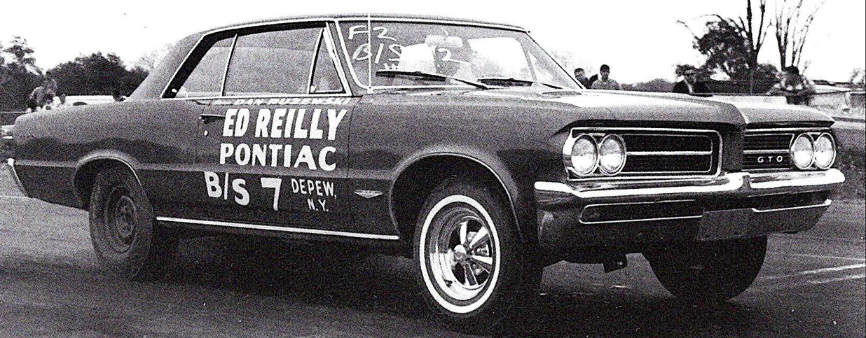

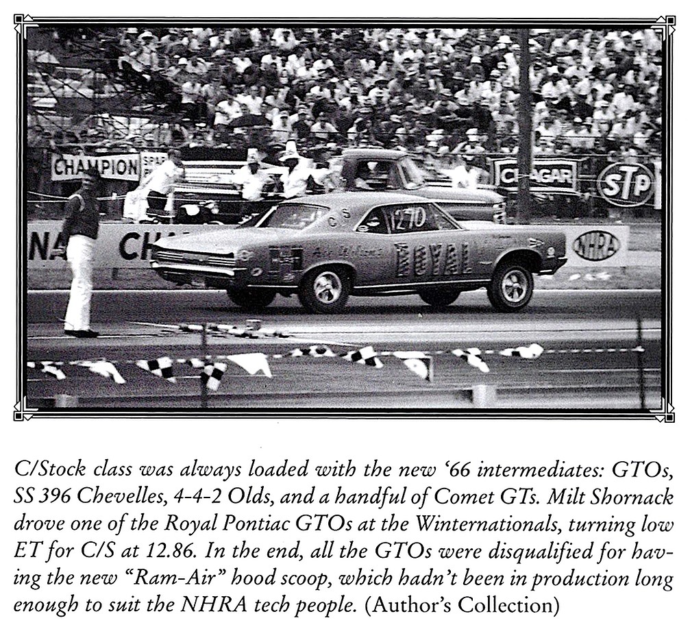

Here's a couple more pics from the SS book.
#1 is a '64 GTO which was running in the AHRA F2 B/S class.
#2 is the Royal '66 C/S GTO, which ran the quickest ET in C/S, @ the '66 Winter Nats, but got a DQ because NHRA hadn't OK'd the factory RA set-up.
Name:	1 - '64 F2 B-S .jpg

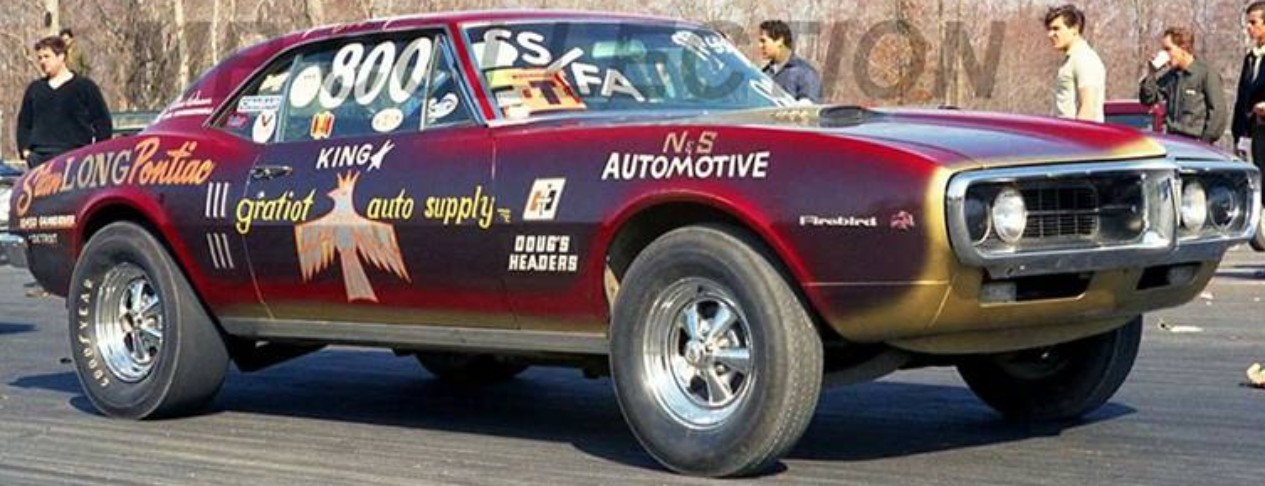

Yeah, I'll take a shot at it.
The 325hp 400 in a '67 Bird could come with, or without Ram Air.
Looks like the RA version has a higher NHRA hp factor. The current factor for SS looks to still be 360hp.
http://www.classracerinfo.com/Engine...5&MAKE=Pontiac
So, I'd say that if the Stocker was running class A, it was running RA, & the SS Bird was not running RA. Hey, that's my opinion & I'm stickin to it.....unless I find out I'm wrong.
"...Unless it wasnt run as a RA1 when it was R/U in SS/FA=9.50 class at 68 Pomona?..."
All he had to do was plug up the open scoops & run without the RA system.
The lower pic is a close-up of the scoop of the 1st Bird. Looks closed & painted black, to me. The Myrtle Bird is marked SS/EA. Assume it was running RA. OR, it may have just been a different year. No clue.
Name:	1 - Long SS-FA .jpg
ID:	61059   Click image for larger version
Name:	3 - Myrtle SS-EA .jpg

"All he had to do was plug up the open scoops & run without the RA system.
The lower pic is a close-up of the scoop of the 1st Bird. Looks closed & painted black, to me"
Great find on that picture. Not definitive but scoop sure LOOKS blocked.
And that's consistent with the 67 Bird RA1 in A/SA=8.70 class in 1967, and later 68 race year cars that only fit when factored to 360hp.
So I'm concluding:
* The RA1 was factored to the GTO's 360hp from 1967-71 at least.
* Knieper's car, though bought new as a RA1 car, just had the hood blocked when converted to SS/FA and ran at the base 325hp rating (or even the 335hp GTO Base rating, same class either way)
