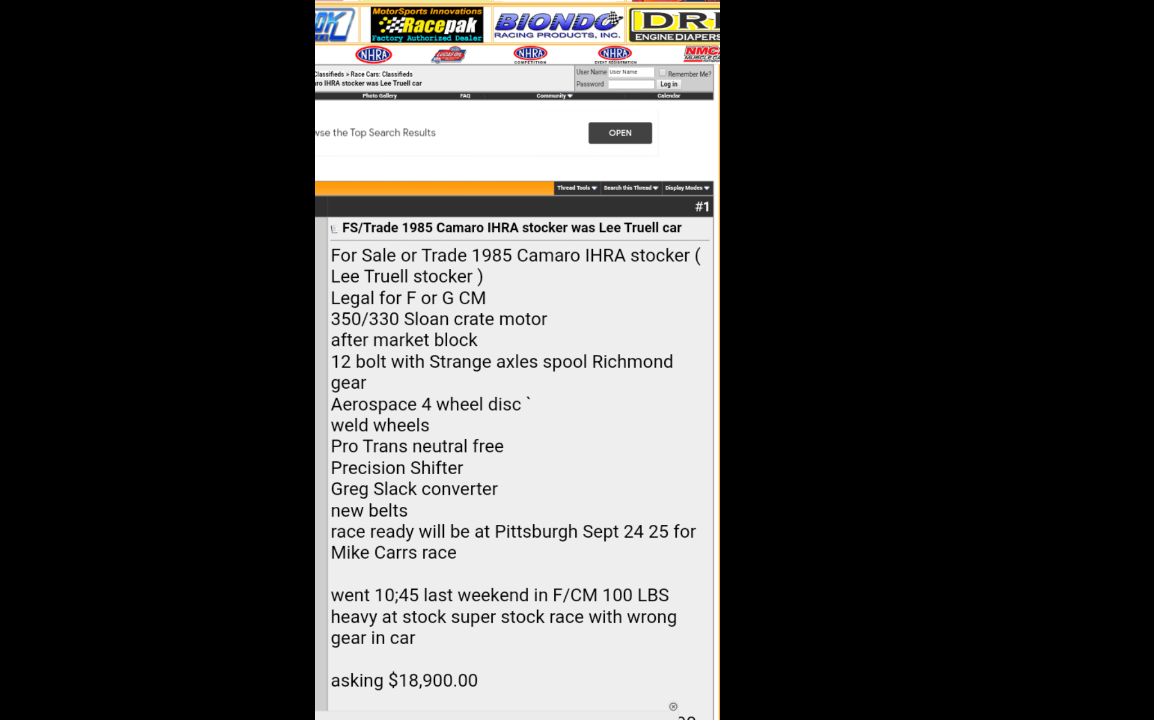

here is the info on my car

Looks like there are two different 305 combos you can run in 1985. Some of the 305 guys can tell you which one is better.
Bobby Lundholm 3516 G/SA
Sell the crate motor and build a 305 for it, sounds like your best bet.
