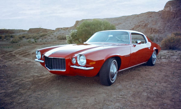

Too many legal stockers with incorrect front ends... if it has the small "bumperettes" it must have the extended center nose piece and the small round parking lights above the bumpers. If the '69 Camaro racers had to replace their cowl hoods with flat ones, shouldn't the 70-73 Camaro racers have to run front grilles,bumpers and parking lights that are correct ?
The only legal combo that was built with the small bumperettes was with the Rally Sport option. The RS option could be combined with the Z28 or SS options but it becomes the "passive" option and the Z28 or SS emblems are displayed rather than the RS script.

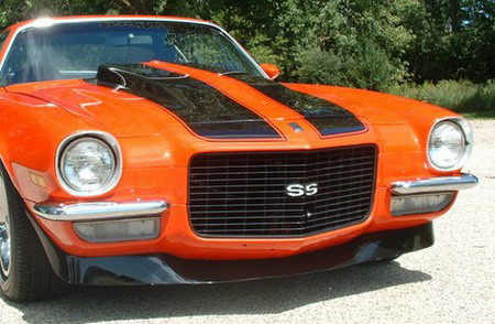

incorrect front combo shown below ... (disregard cowl hood which was also never offered by Chevrolet for these cars)

The correct RS front end is heavier , the euro bumper around the grill is not light and yes there was never a split bumper with the lower marker lights

Its a simple fix. Take the split bumpers off and install the one piece bumper.
