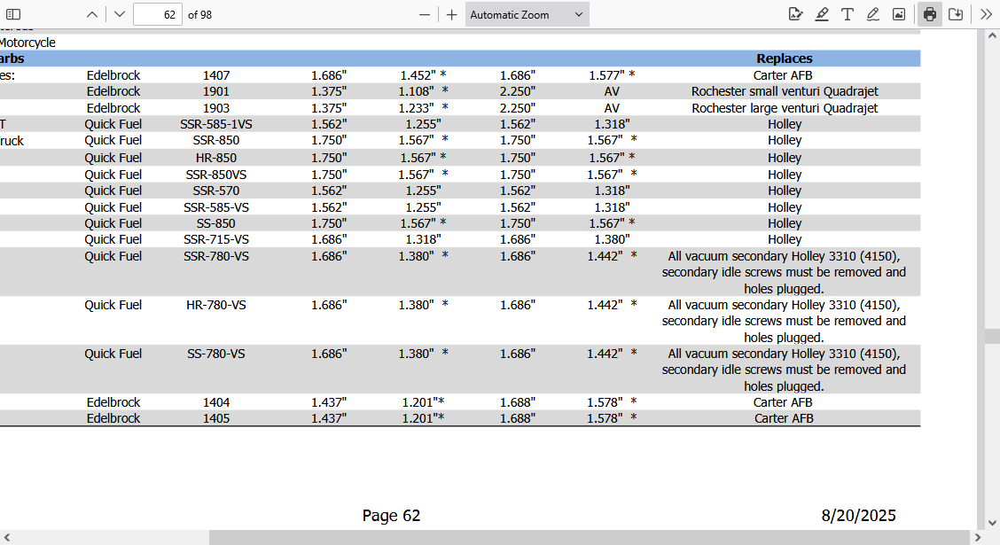

There is no performance advantage. It's a simple idle tuning modification.
Consider what they're actually letting pass, the rule/ruling is absurd.

A l a n, now we have no holes and with holes. Were they approved or not? Makes a big difference here the way I see it.

Likes: 1,605
Liked 1,915 Times in 430 Posts
Default Re: Tear Down B/S ... must read
Originally Posted by Steve Stasko View Post
I don't understand this post. The rulebook clearly states the holes may be drilled in the PRIMARY plates, other modifications prohibited.
The "year, make, model" rule has not been enforced in at least 20 years.
This is a selective enforcement of a selected part of a rule not enforced for the most part for decades.
With all due respect for Wesley and Travis, that's a "fix it" violation at most. With zero performance advantage.
As I stated in another post, considering what they allow to pass, this one is pretty ludicrous.
Alan Roehrich
212A G/S
Yes, the Quick Fuel 780 as approved, accepted, and delivered, came with holes in all four throttle plates, and we were told to drive lead plugs into the openings to cover the secondary idle mixture adjustment screws.

Seems pretty clear to me. NHRA accepted the QF carbs but they don't want you idling off the secondary side, just like the factory Holleys were set up. Add to the fact that the rule book says ..okay to drill the primary side only...there you go .
It is a shame that it wasn't noticed 5 years ago...
Everybody said they wanted more tech. Now you've got it .
As far as the disposition / punishment goes...Not up to me .You guys can argue that out ;-)
https://www.jegs.com/i/Quick-Fuel/79...W05YXkaAn48EAL
