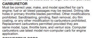

I don't understand this post. The rulebook clearly states the holes may be drilled in the PRIMARY plates, other modifications prohibited.
