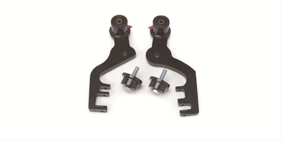

Variations of these work well... http://www.summitracing.com/parts/hal-5213/overview/

OK, that's one vote for no hop bars. Is that what most of you coil spring guys are using ?
Just for reference those were used in this '66 Chevelle 396SS. Basicly a street car with minimal mods...5.38 gear, TH350, Moroso front springs, running full street trim at 3800 + pounds. Best I remember was a 7.00 1/8-mile with a 1.50 60'...a real lead sled.

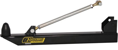

(6) What about the coil spring "slapper' bars ? Are they totally useless for Stockers ? Sorry about my ignorance on this subject. I've just never used any of the above products.
http://www.jegs.com/p/Competition-En...37234/10002/-1

This site is a good source for answering a lot of your questions.
http://www.baselinesuspensions.com/
Necessary to me would be anything that gives an advantage, but at the same time, I had a 71 Monte Carlo SS 454 back in the early 80's that would run 11.50's with 1.50 sixty foot times with nothing but air shocks on the rear, lol.
