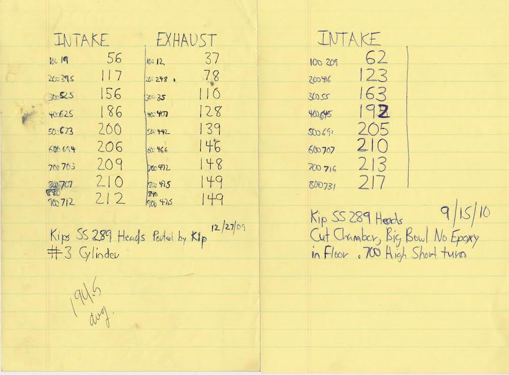

Capri if that is all they will do, then that is it. This is the kind of information I am needing to make a decision. Let us not forget that they started at 154 so that is a good improvement. I would love to hear some better numbers but?

Key words being "289 heads" Kip had "special" 289 heads..............
Heres the flow sheets on Kips 289 heads. Tested on a SF 600 sealed 4.00 bore @ 28 inches. I also have a (289) flow test from another well know Super Stock head porter as well peaking @ 215 CFM.

Originally Posted by Capri View Post
LOL @ 219 with 289 heads................... I will say no more than that.
I stand corrected peak flow was 217 not 219 @ 28 inches

I have a little hope after seeing these numbers, I wonder what/whose cam was installed?

Really don't see what more you would need to know, you've got the flow test from the fastest 289 Ford SS/L on the planet........I wouldn't worry about more opinions, I'd just get to work. You also know it made 467 HP @ 7400 RPM STP on a SF dyno. First hand information.
Word is bond !! Thats really impressive for a 289 head !! What you need is a D 1 carburetor !! that picked some up about 3 tenths 25 years ago !! some have special "heads" n others got "special" carbs !!
