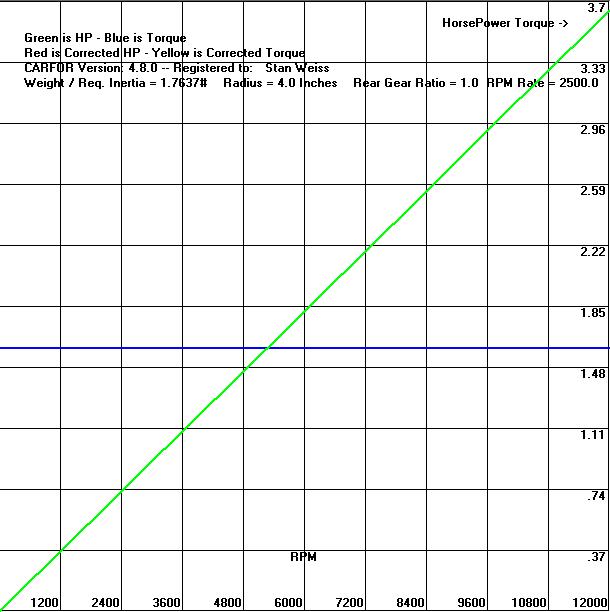

100 grams * 8 = 800 grams / 1.7637 lbs
Let say that weight is at a 4" radius with an acceleration rate of 2500 RPS.
Stan

That depends on where and how much weight was removed. Is the part now no longer as strong as it needs to be, and it is flexing which will cost you more HP than the weight saving gave you?
