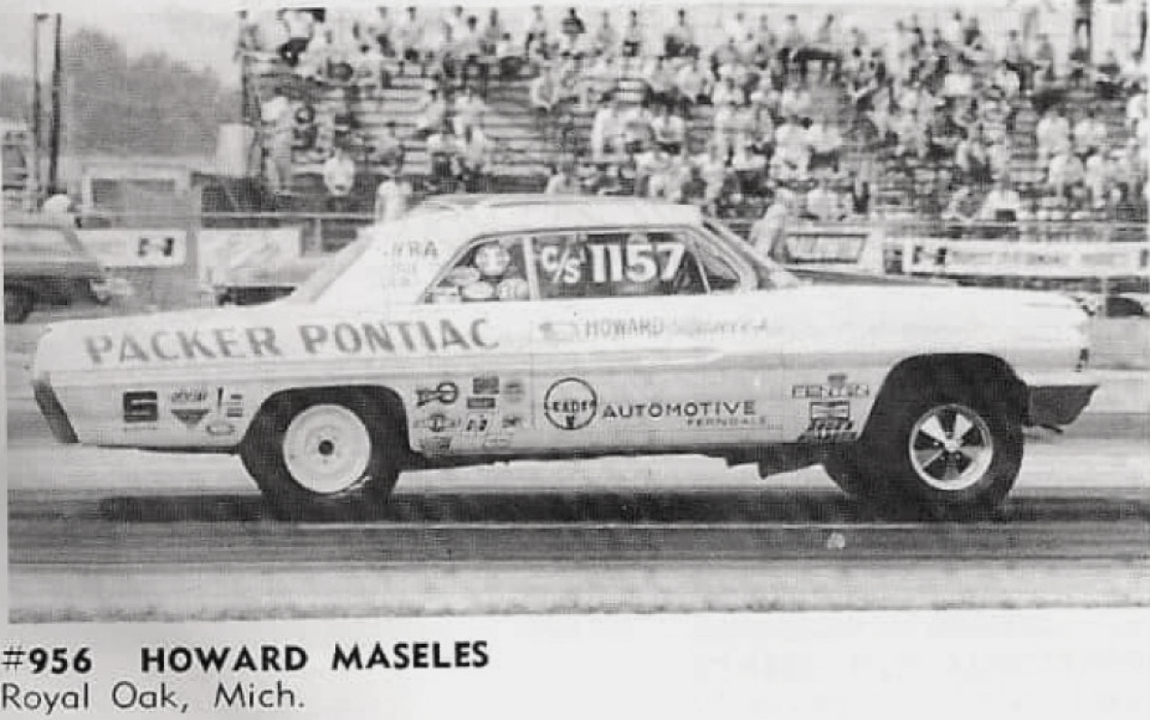

This is the same list I just commented on, which was listed as 1968 Indy.
Howard Maseles won C/S, with a 12.22.
Don't know what year this was.
Name:	1 - Howard Maseles .jpg

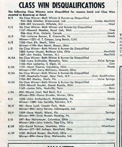

Glidden was DQ’d.

RP - Great find I hadn't seen that long DQ list.
Will have to work thru that.
I wonder if the Glidden intake was a Medium Riser intake NHRA didnt think was legal even though it was production, since the NHRA Blueprint files are wrong to this day.
But so many others DQ. Will have to update my summary!
