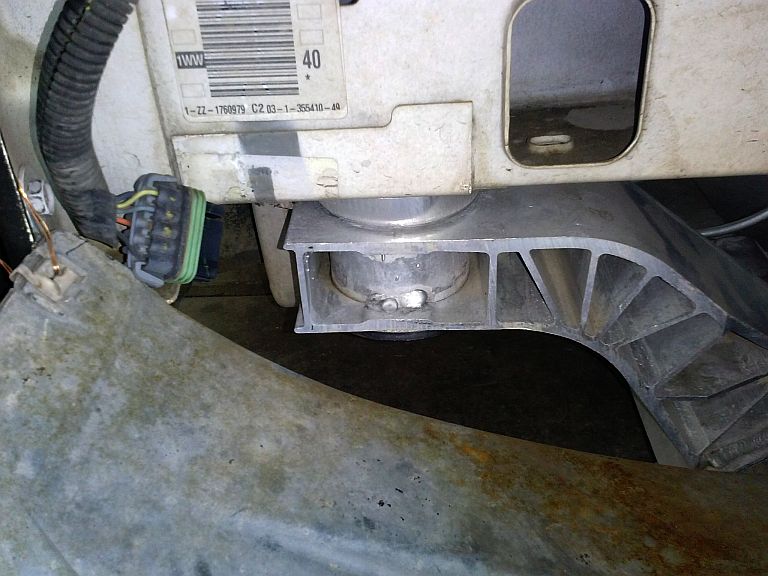

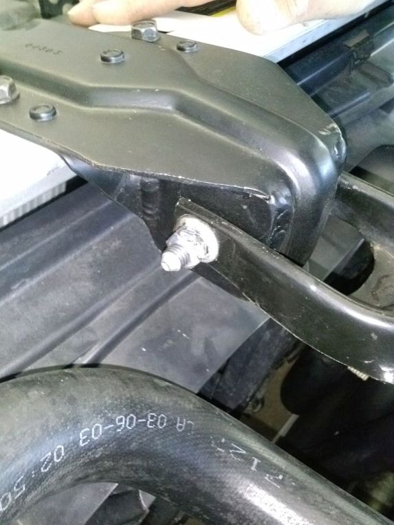

Solid upper torque arm and lower cradle bushings
ID:	29415   Click image for larger version

Thanks for more pictures Mark. I definitely have to purge my brain of street vs strip cars. I knew the torque arm bushings needed to be firmer, but never really thought about solid. Did you do anything to the lower motor mount and transmission mount? Looking forward to anything you can share. How light were you able to get it before you started adding weight back?
