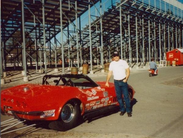

This car ran s/st at the 1997 Dutch Classic.
Mario DiTeodoro III SST/SG1226 STK126M

SST1226 I like your car mine will be a little older 1964 and a Ford not a Mustang!
I like the factory windshield look is it mandatory or can you not have one and use a small one like on the roadsters now? Does the passenger compartment have to be covered also? Sorry for all the questions but want answers from people that have ran them! I saw a 66 Chevy 2 that was converted it looked great also a few 57 Chevy's ! Any pics of cars please post.
Thanks!
