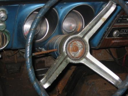

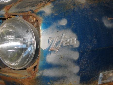

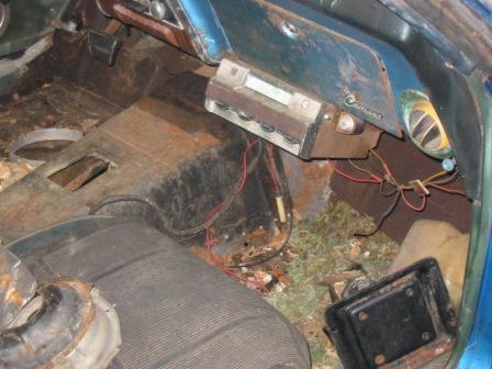

Old 09-27-2010, 10:29 AM   #44
Burner
Join Date: Mar 2009
Posts: 16
Default Re: Can you settle an argument?
Burner,,,,,check to see if you've got an 8,000 rpm tach,,which was Z-28 only. Also, all dual exhaust cars had plates welded behind the rear wheels on the subframe for exhaust hangers,,something else to look for. Nice barn find,,,more pictures please!
Danny Durham
Some more pictures, these are of the day i found it, I have yet to take any more, the tach shows max at 7k(see insert) I have read several books and seems like there are several differant thoughts on the tach, anyway still have'nt made up my mind yet, still researching it. I have a Bracket finals race this week but will check out the plates ASAP.
any input welcome, thanks again
