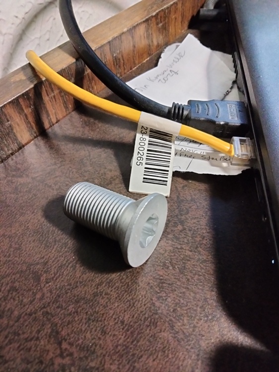

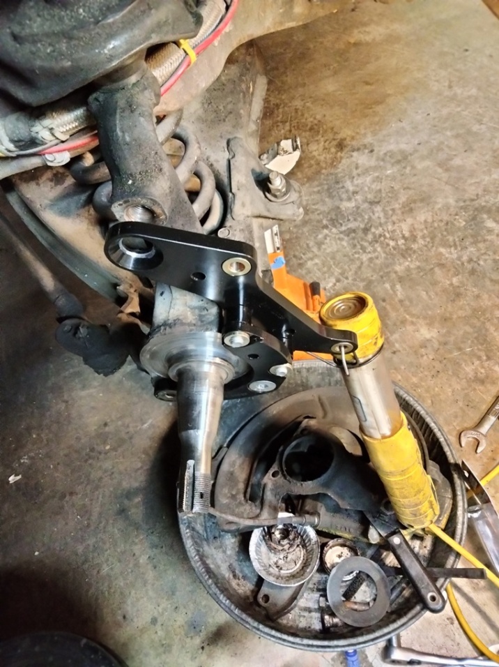

I'm in the process of changing the front discs on a 74 Corvette Bracket car from stock to a Wilwood setup. The upper bracket mount bolts to the stock spindle with a 11/16-16 Torx bolt (supplied from Wilwood). The bolt is 1 1/2 in long and needs to be torqued to 140ft-lbs. The problem is that when the bolt is spaced as per directions, there are 3 threads making contact in the hole. Not nearly enough for 140 ft-lbs!!

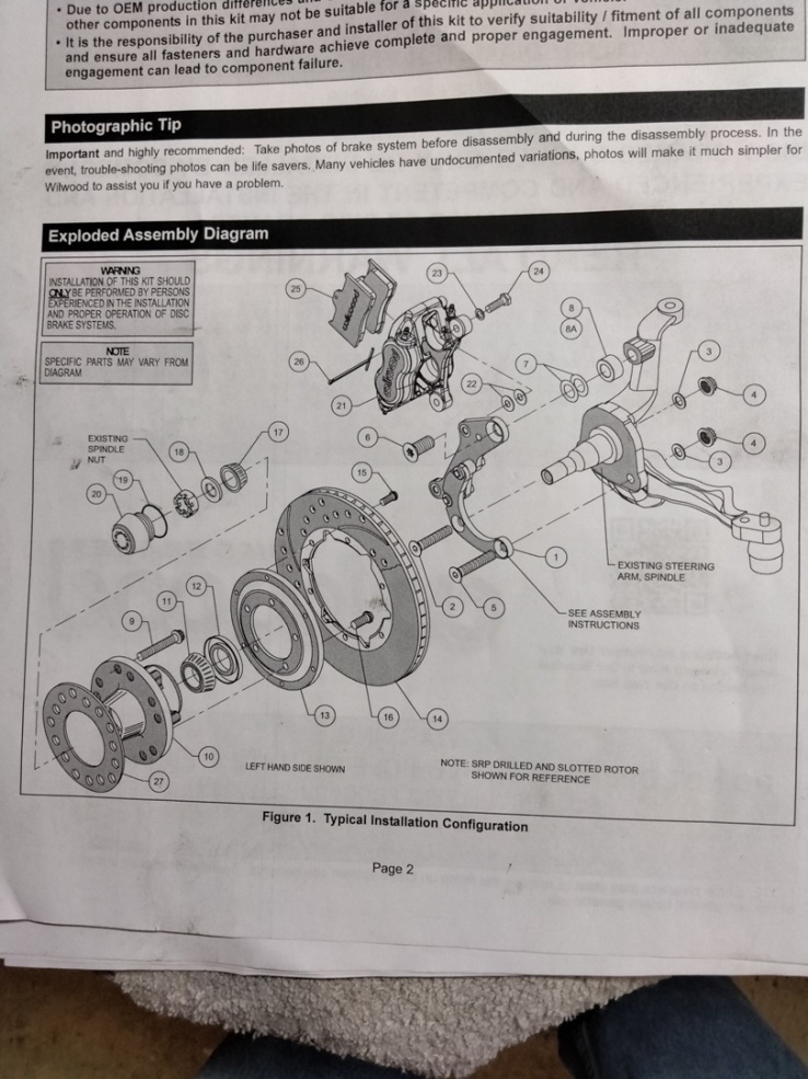

Wilwood 140-12040 Brake kit for 69-82 Corvette Front. #6 on the blow-up pic. McMaster-Carr has bolts that are close (hex-head 3/4-16), but would need to drill and thread the hole. A bit much for a 'Bolt-in' kit!

Walt does the threaded hole for #6 go all the way through the spindle? If it does I think I would go down to a 5/8" bolt with a nut on the backside of the spindle
If the thread does not go all the way thru you may need a 3/4" "bottoming tap" to get enough threads in that short a distance. Ray

Its a 'blind' hole. I haven't measured the hole, but looks like it is about 3/4in deep. As I might have mentioned, I'm talking to Wilwood to get a longer bolt. They have bolt 'kits' and one for the 63-64 Corvette (drum brakes) seems to have a longer bolt, just looking at the pics. That kit is about $95.00, so I'd like to be sure before pulling the trigger on that!! 3 threads is pretty sketchy even if I got it to tighten up! Monday may bring some relief.

Are bolts 2 and 5 in the blue print look like there long ? Would they work if they shipped you a Qty of 2 ? ... I see they are differant after looking closer , top bolts are 11/16-16 & really hard to find hope they can help you they just overlooked that detail .
