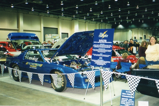

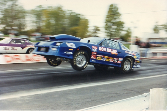

I wouldn't ***** 💩 you. I'm a POOR BOY. I haven't race my MPR 92 Camaro in 27 years. My car has only 20 to 25 runs on it. It still has the New Race Car Smell. I parked it when I got married in 97 and started my Family. So, with a little Luck and a few dollars. I might get a chance to race next year. And make some improvements.
ID:	69032   Click image for larger version
