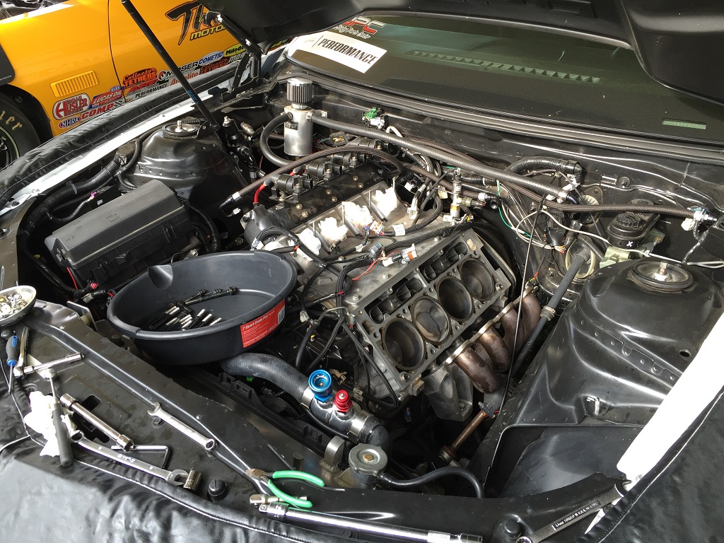

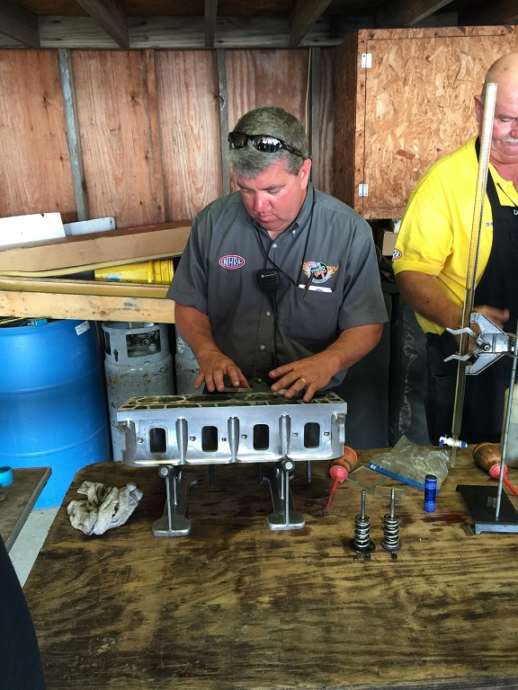

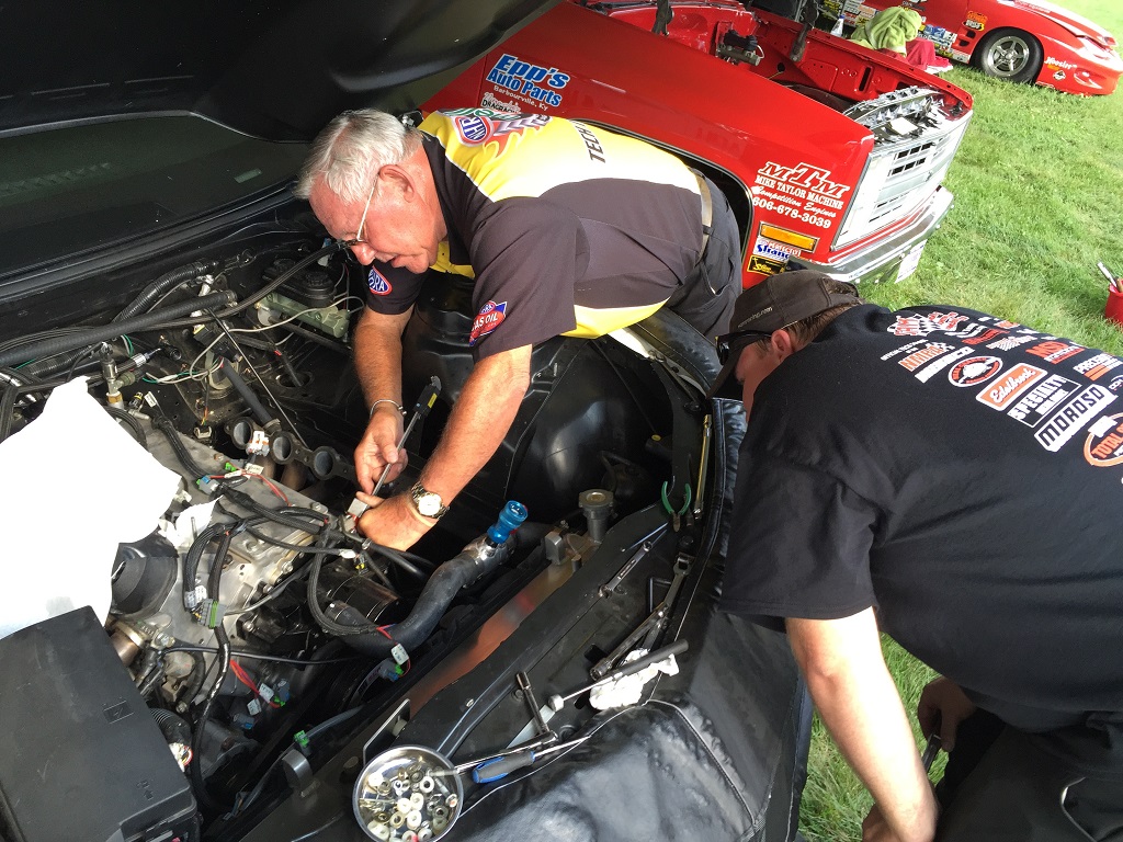

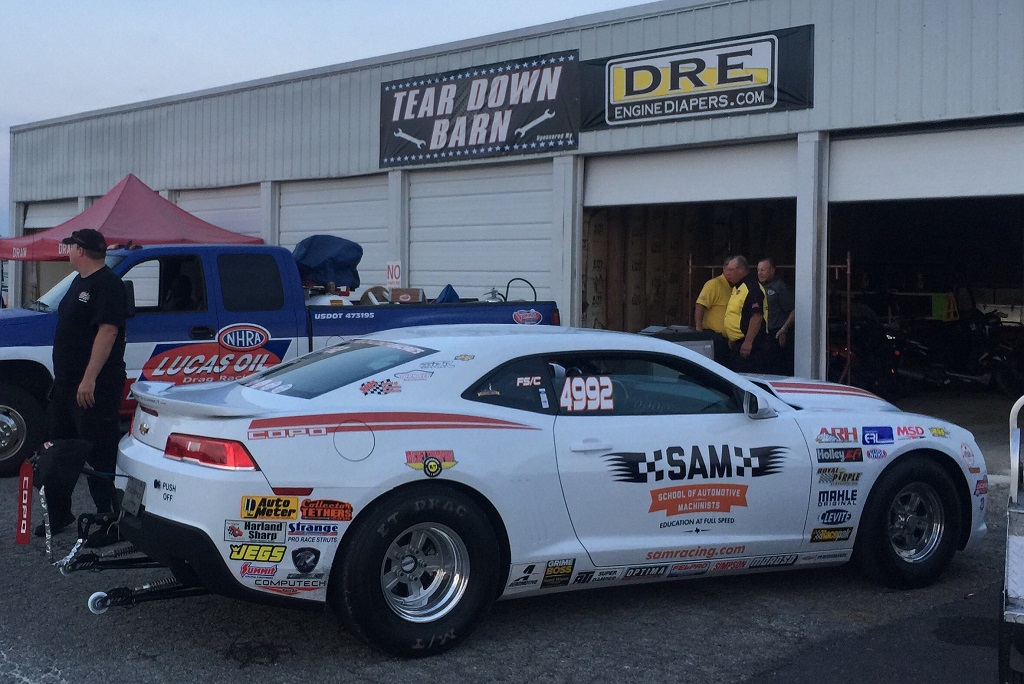

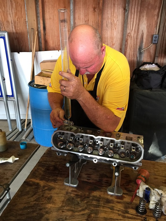

The School built this engine 100% to the rules as we interpreted them. This specific engine was torn down at the 2015 Chevrolet Performance US Nationals. The engine passed tech. The tech guys did a very thorough job including;
intake port
exhaust port
chamber
valve head and stem size
bore and stroke
deck
gasket thickness
cam lift
lifter plunger travel
intake manifold and throttle body
-Brian
