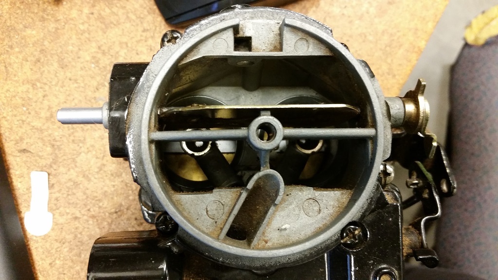

I'm not familiar with the Mercury Marine carb.Made by who?
Link? Pic?
Old 09-30-2015, 07:08 PM   #39
T Ketels
Join Date: Jul 2005
Location: Dyersville, Iowa
Posts: 52
Default Re: Rochester 2GC info
Here's a couple of pictures of the marine 2G - it measures 1.375 but it has sleeves in each bore. I've never built one to try yet - one of these days.
Tim
