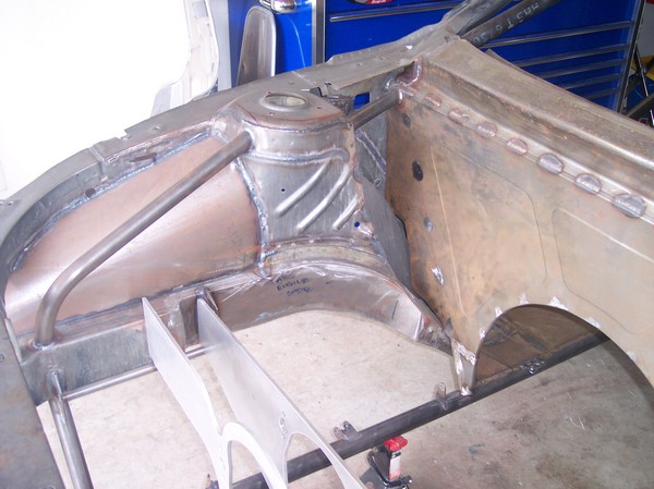

Would this work?

Originally Posted by colby View Post
Would this work?
in my opinion I would e-mail the drawings to the tech department at nhra, or your div. tech director. to get an approval, and save or print the e mails. so if down the road there is a problem, you have some correspondence to show.
Anyone?
The design looks great as regards to stiffness from an engineering standpoint.
Nevertheless, the installation looks quite forward from the firewall.
You don't want to compromise the advantages of engine setback.
Also remember that the rule book specifies that for the Chevy Cobalt, the distance from the radiator core support to the firewall for Super Stock GT and Super Stock Modified is a maximum of 33 inches. For Comp Eliminator Super Modified is a maximum of 34 inches.

Default Re: Mid plate vs. no midplate
Just got word back from NHRA that the design would be acceptable. The spacing the model shown was exaggerated slightly to help show that there was a separation of the firewall and midplate. In reality the front surface of the midplate will only be 1" from the firewall. With the LS style engine they actually have no bellhousing flange like a traditional SBC, so the mass of the engine is already offset to the rear over an inch. The engine really has to be offset from the firewall or the head will basically be touching it.
