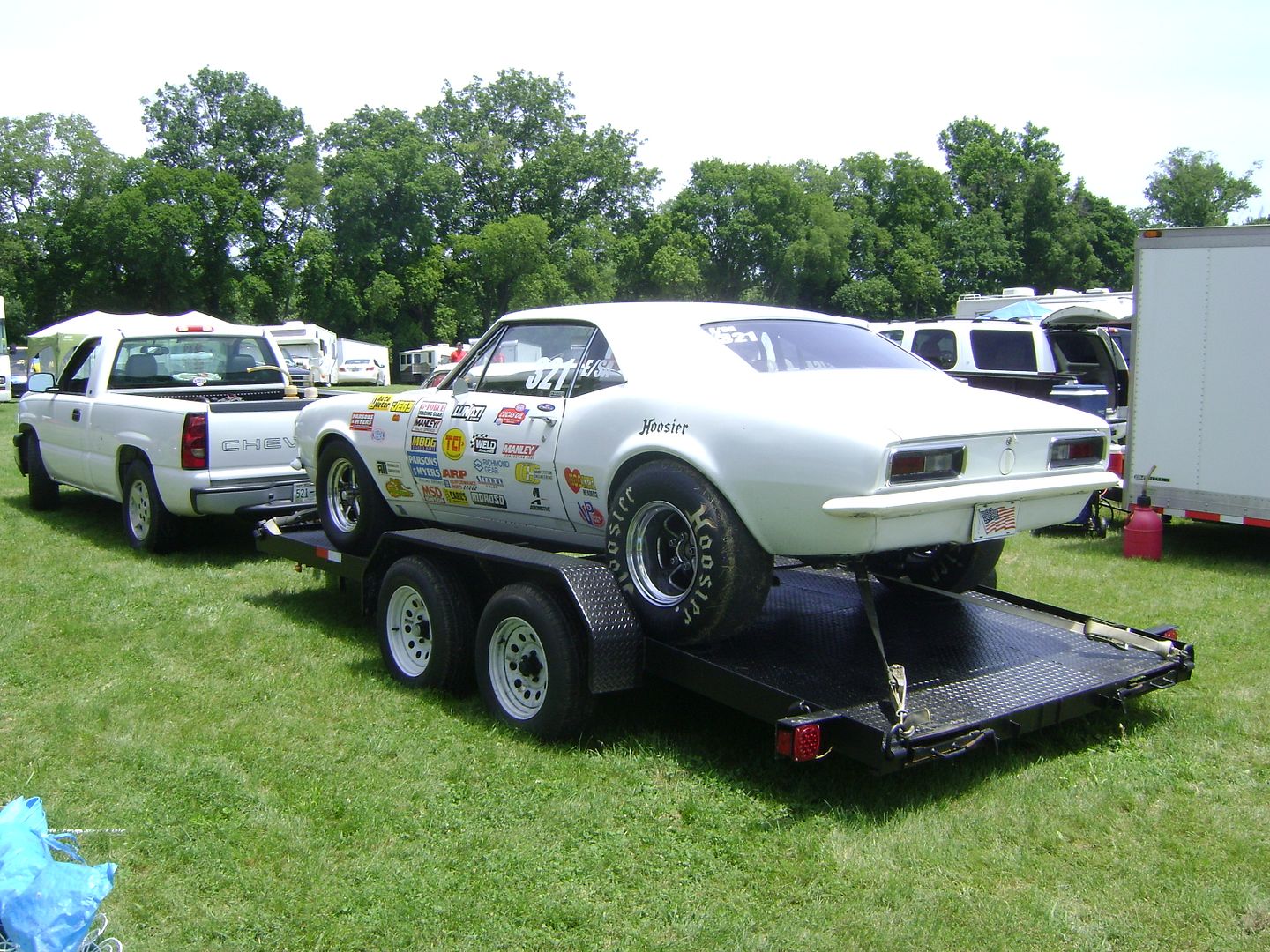

15x10 w/5.00 backspace here. Pretty close, about the most you can get under these cars.

Default Re: 1967 camaro stocker
WOW !!! Look @ all the shiny. Nice.
Look'n Good!!
