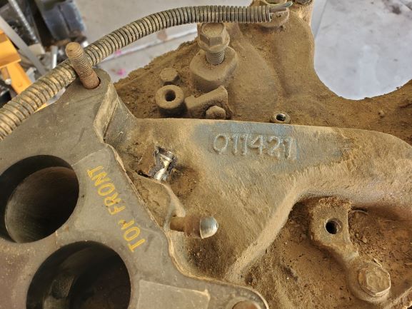

Can anyone tell me what year this intake is. It's a aluminum 2bbl intake i think 82 but not sure

Whats the casting number on the intake manifold ? It should start with either a D or E.

Default Re: Ford 2bbl intake
Originally Posted by Mike Gray View Post
Don't see it there.
82 HO was the first aluminum and the last true 2 bbl. intake
83 and newer CFI intakes will take a 2 bbl. carb though.
Anyway, that's not the part number for an 82 .
E2ZE ----CA is what you are looking for.

Ok thanks, guess ill have to blast it clean and see if there are any other numbers on it. I was told the motor came out of an 82 LTD and was hoping it would work for my 82 mustang GT

Talk about a lucky find. The motor has the AB heads and the right E2ZE intake on it to build a 82 Mustang GT!
