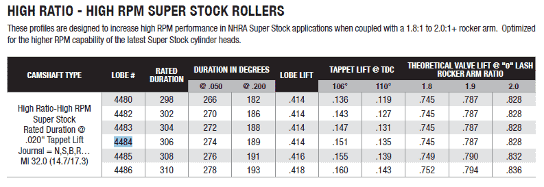

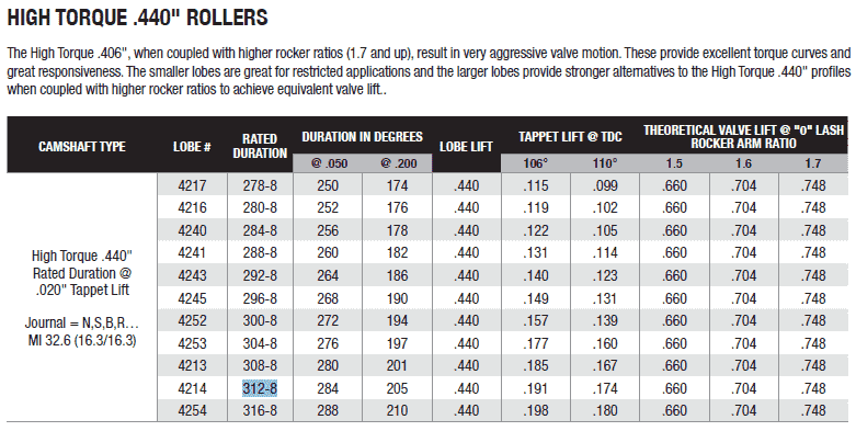

Anyone know the specs of the following cam? It's an older SBC Super Stock cam.
Comp Cams 4484/312-8 R6
Grind number R 7305
Comp was no help. Thanks in advance.

Don't know what you are looking for. This is from an older Comp Cams Master List I have.
Stan

Stan had the intake correct, high ratio, high RPM Super stock, using 1.8 - 2.0 rocker.
The 312-8 is a High torque .440 lobe, 312 adv., 284 @.050, 1.5 through 1.7 rocker ratio.
And you probably know it was ground on a 106 lobe separation.
Phil

OK here is what is listed the exhaust lobe.
Stan

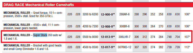

Any thoughts on a lash setting?

No, I don't have any idea on lash settings. But remember lash will depend / change based on what rocker arm ratio you are using.
Stan
PS - I found this. It might be a good starting point

I went through the Master Lobe Catalogue and came up with the same as Stan The side bar mentions .020. Try that. My 302 Ford with a Crane 448511 cam.254/262 with .599 lift lashes at .020 hot. Sounds like my stick is a lot like yours. Just Blue
