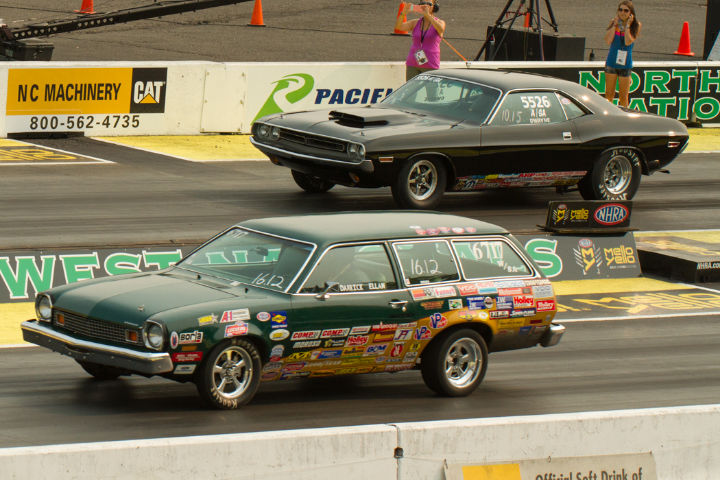

Darrick Ellam runs a Pinto wagon in W/SA out here in Washington State. I'm not sure of the year and engine, but it screams and is fun to watch.
5.97 sec lead over the A/Stocker

Originally Posted by FireSale View Post
Darrick Ellam runs a Pinto wagon in W/SA out here in Washington State. I'm not sure of the year and engine, but it screams and is fun to watch.r
Ellam’s wagon is a 2.3 and after watching him run it all the way to R/U at the Vegas Divisional plus seeing his lights and the car’s relative consistency (not to mention a good run against Calvert’s Cobra Jet at Pomona) I would love to do one of those myself. For kicks go to D3TV’s YouTube channel and look at the Vegas race....guarantee you’ll love it.
