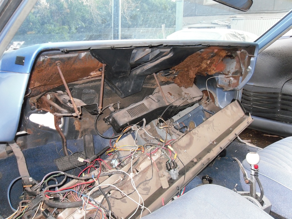

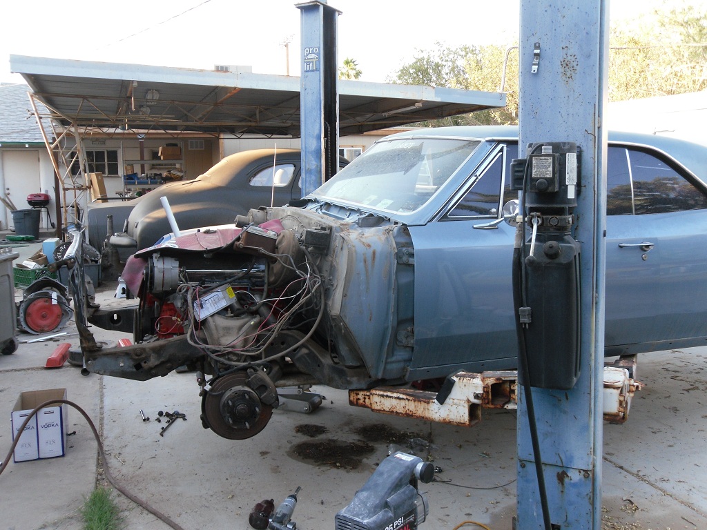

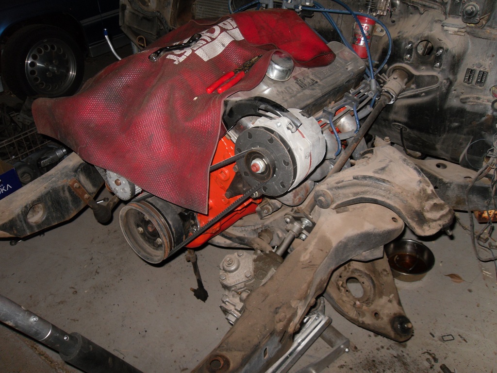

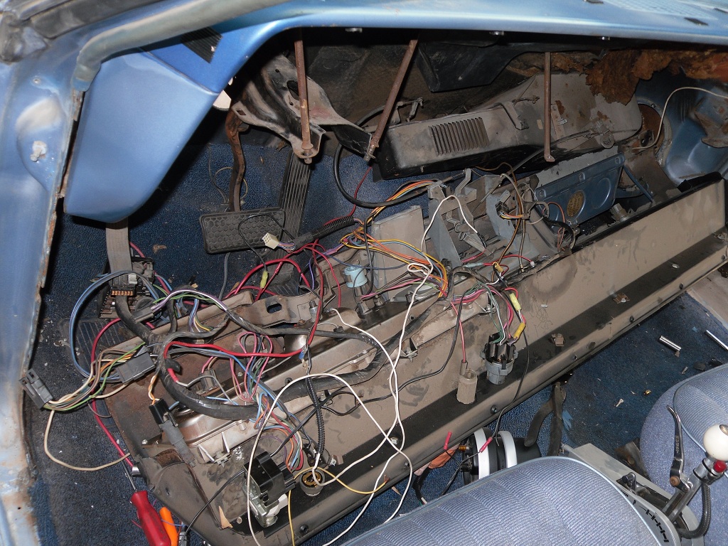

With that lets get started on this: My 1966 Chevelle 396/325 I bought in 1988 for $900.00 and drove home rust free AZ car...let the tear down begin...

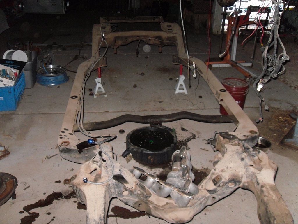

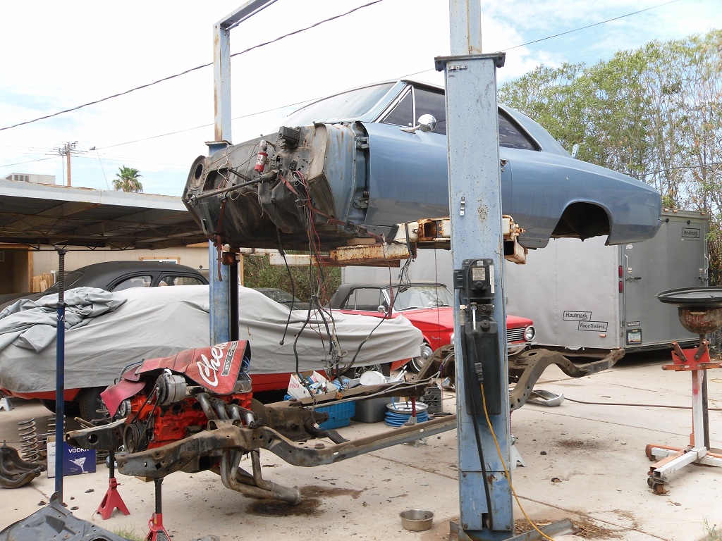

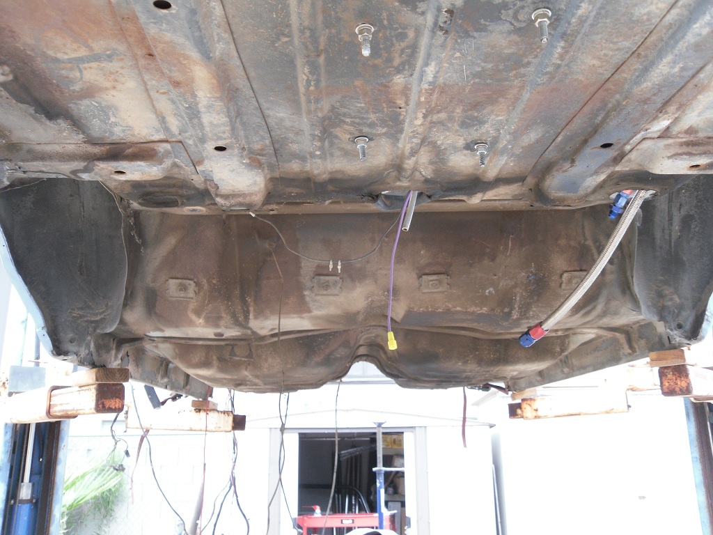

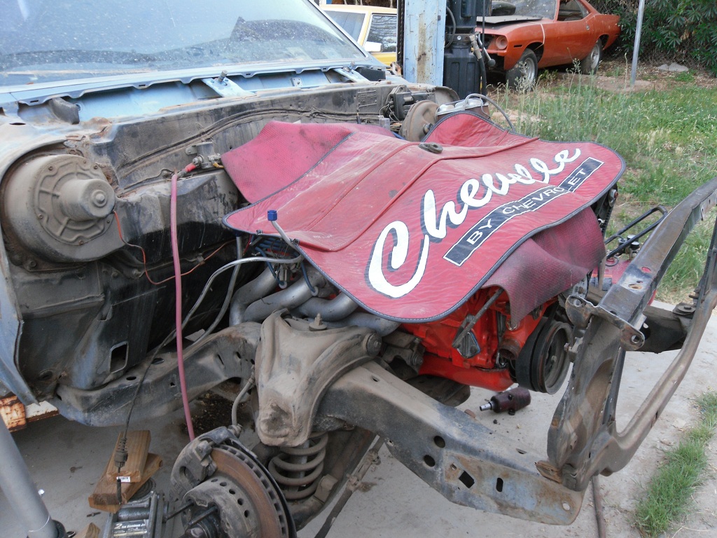

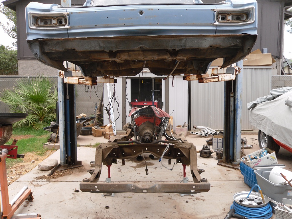

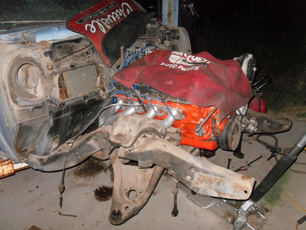

Full blown frame off... This was a running car when we started....We chassis dynoed it first with a stone stock original engine, with heavy TRW's and an off the shelf cam....

as You can see...good clean fun...

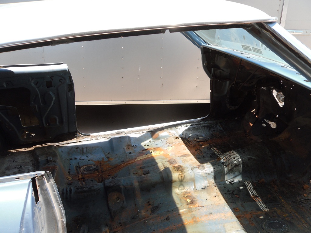

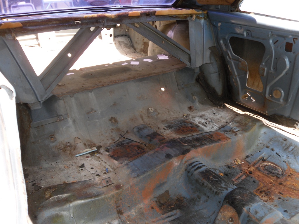

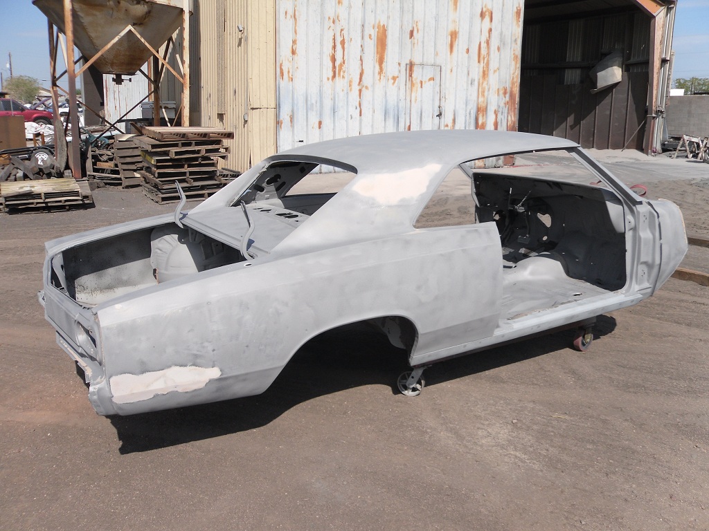

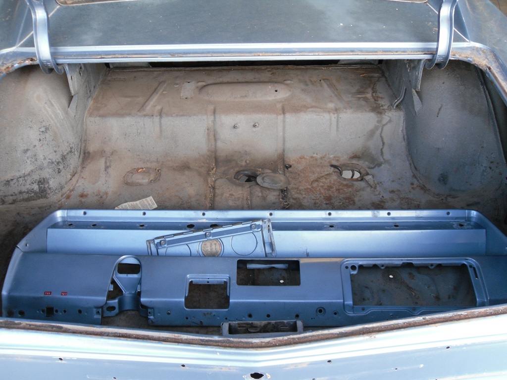

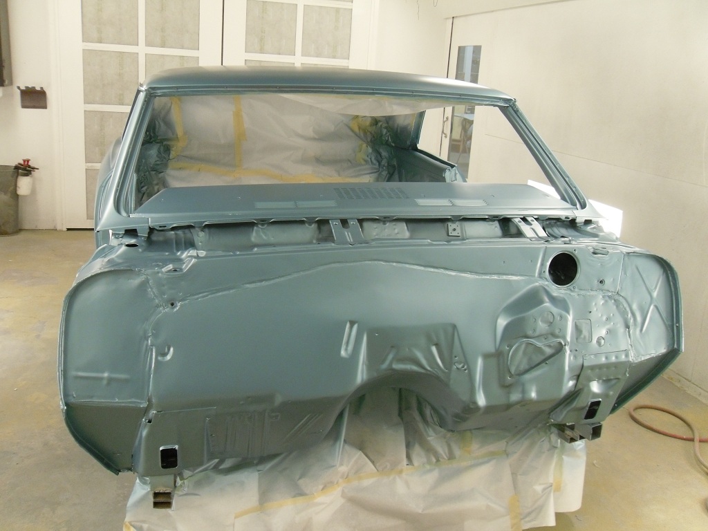

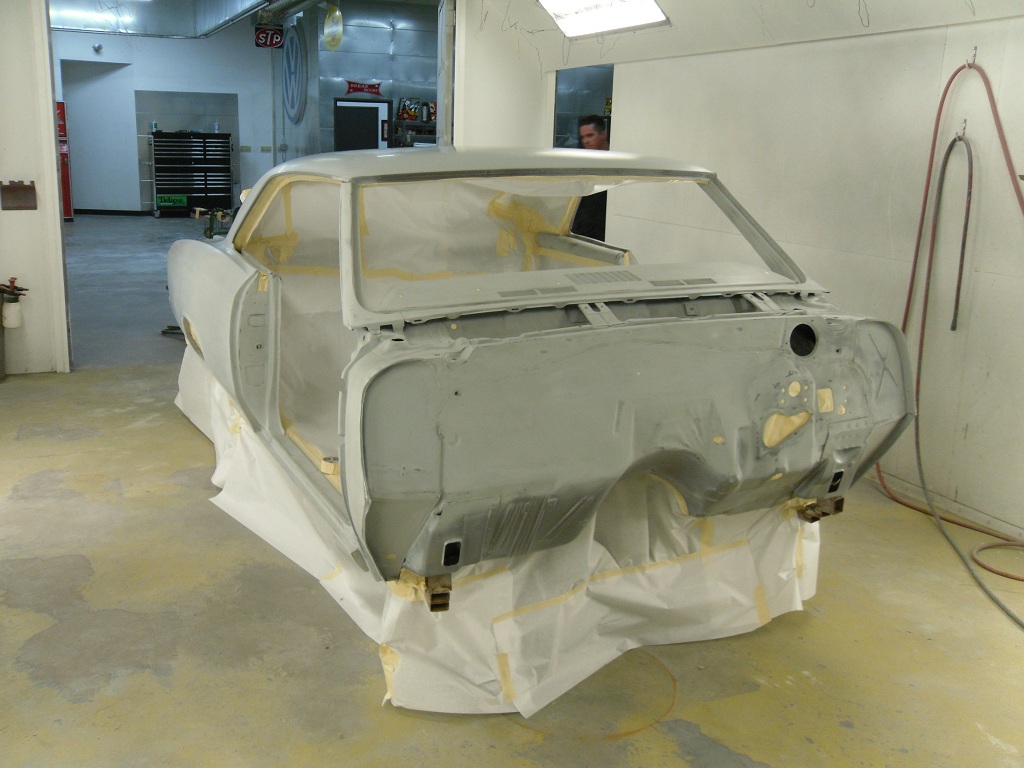

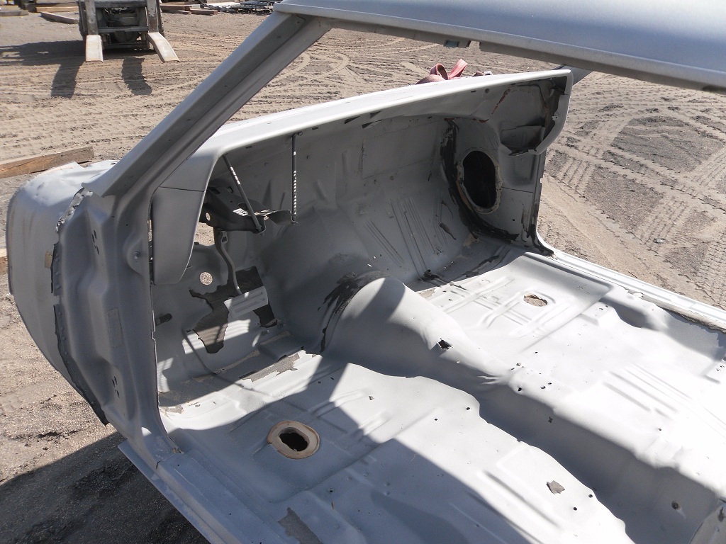

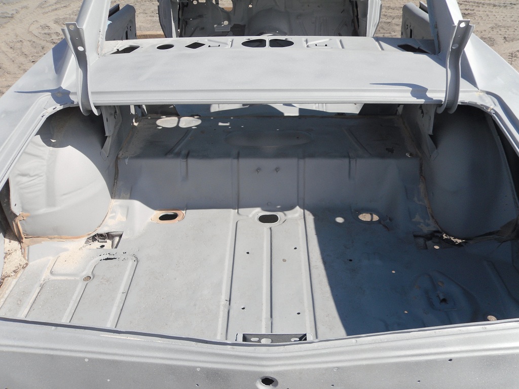

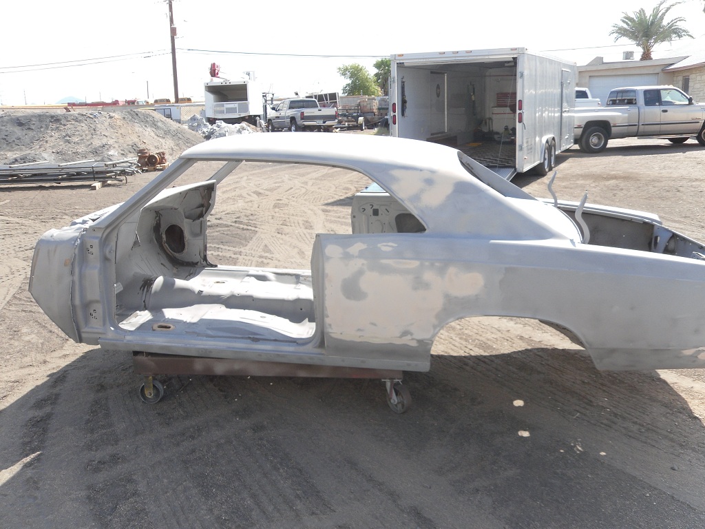

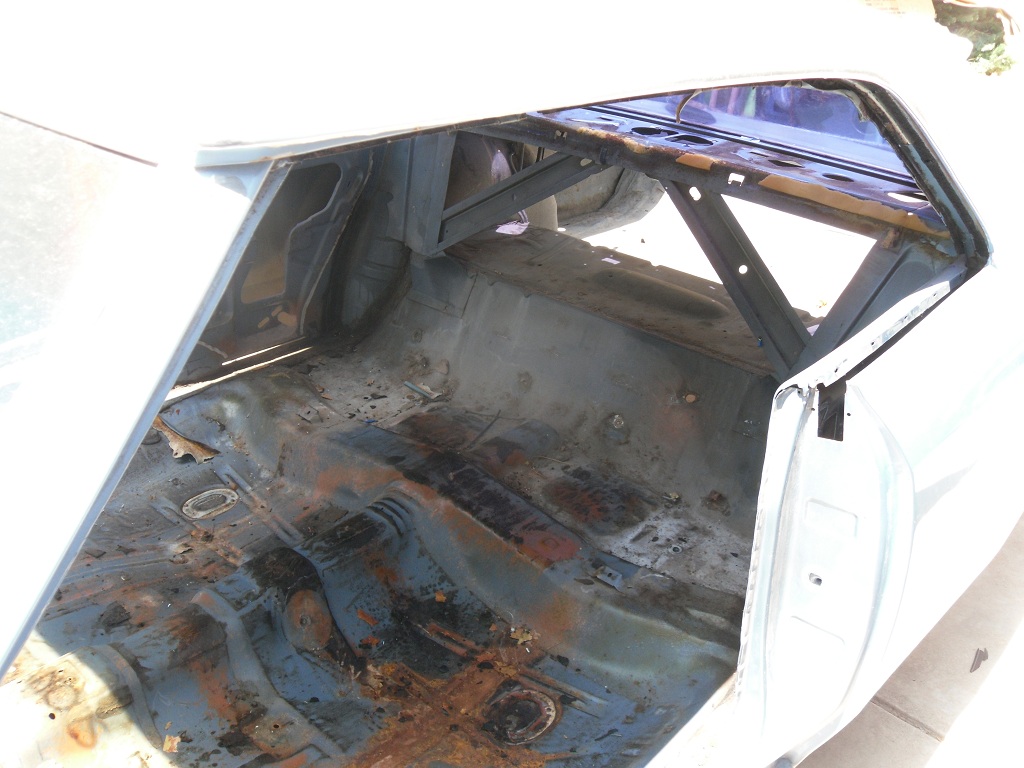

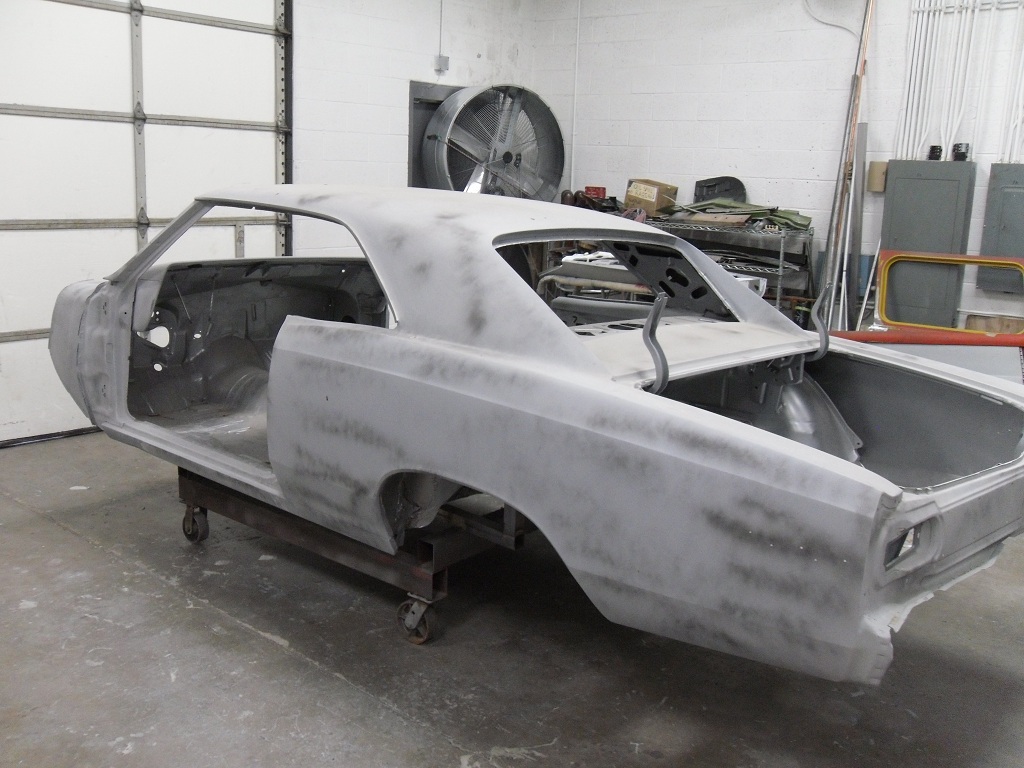

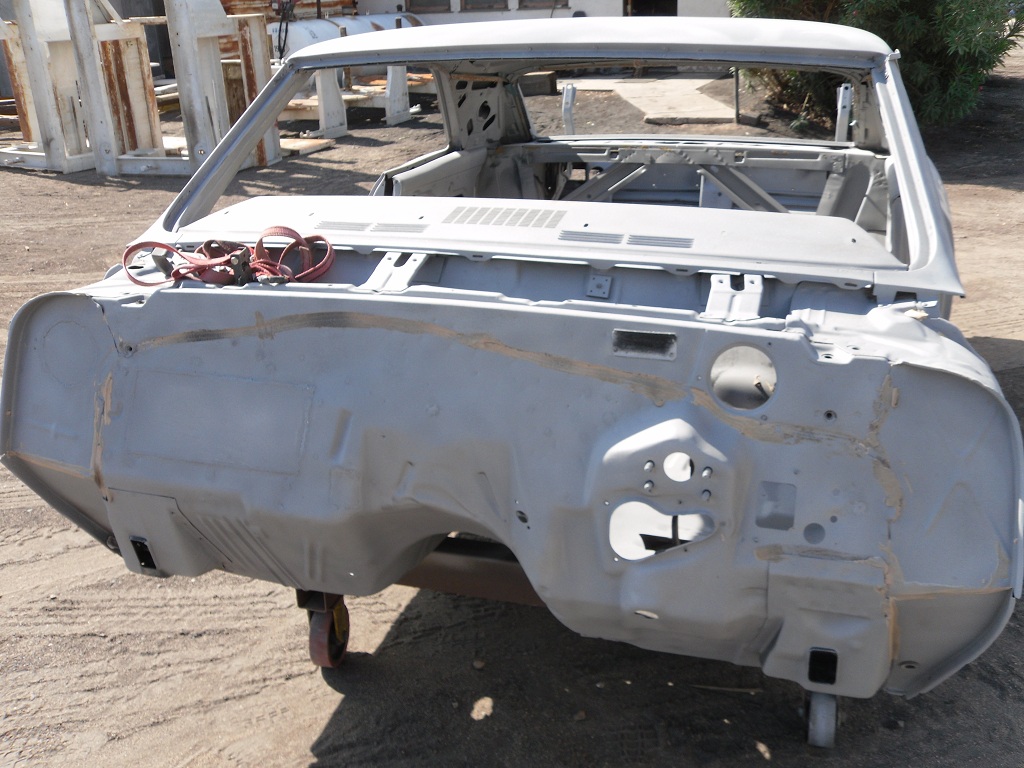

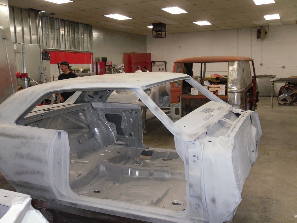

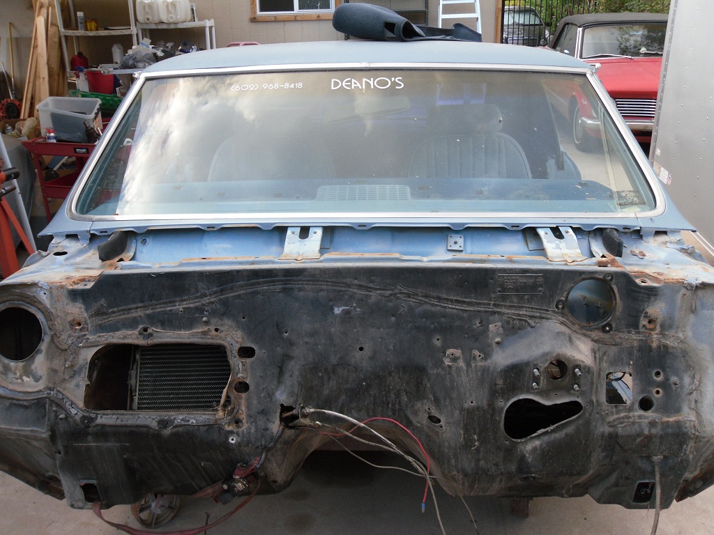

Off to the sandblaster and the start of body work. I removed EVERYTHING from the body...seamsealer,under coat etc. Bare metal blank Canvas.

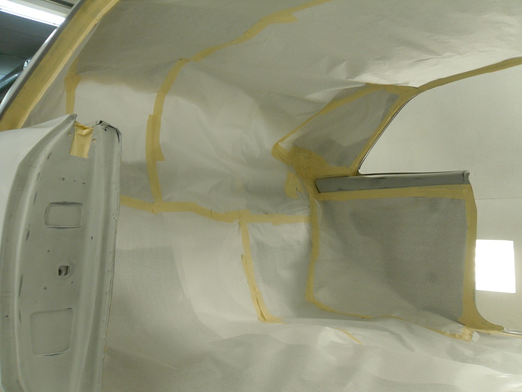

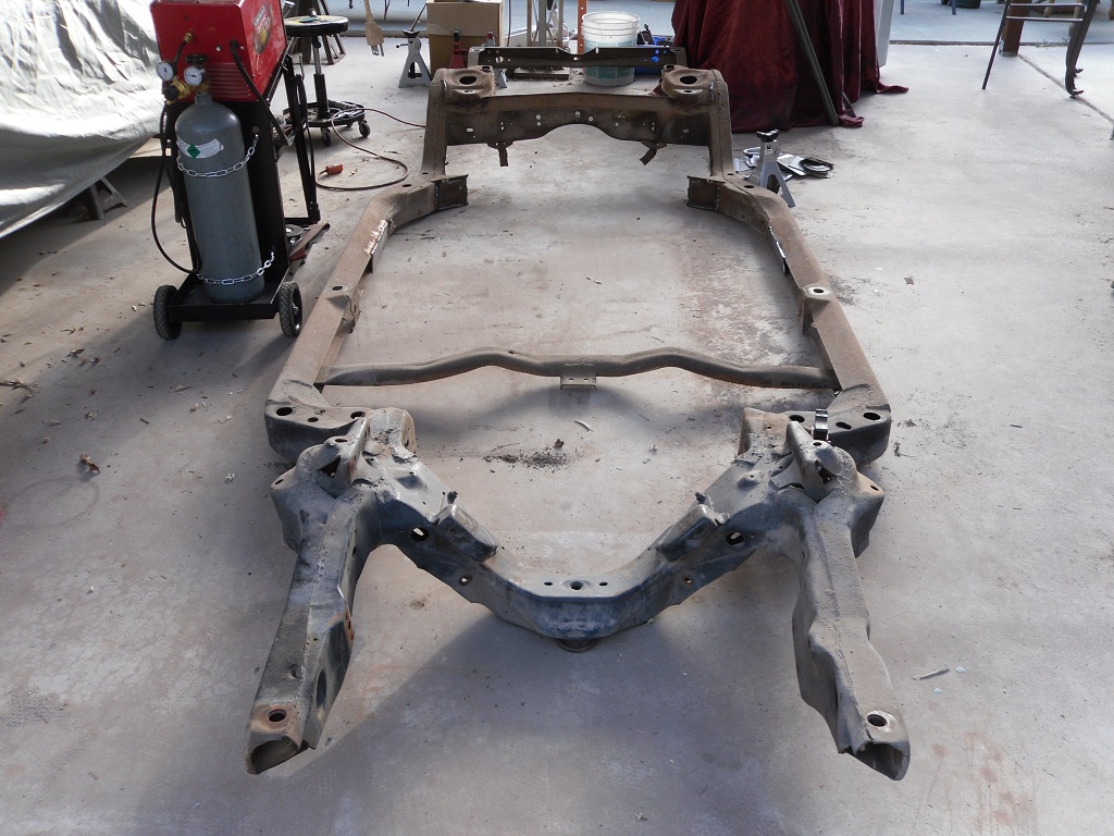

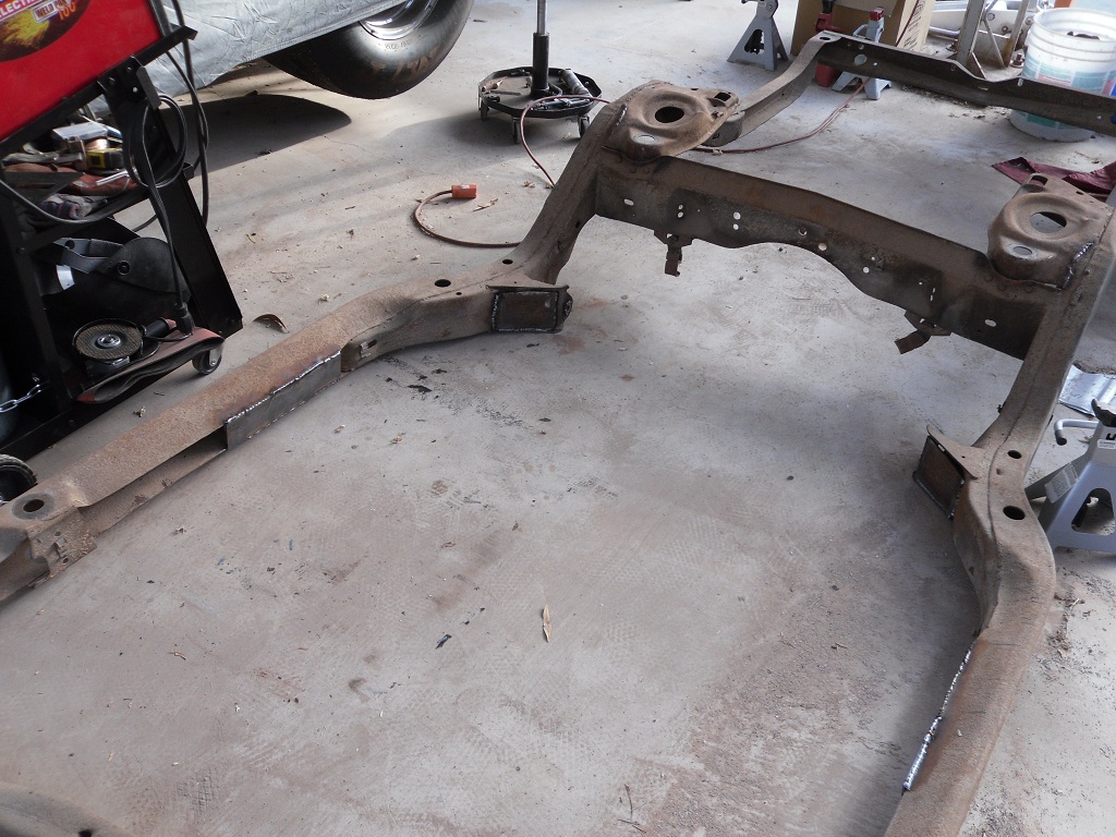

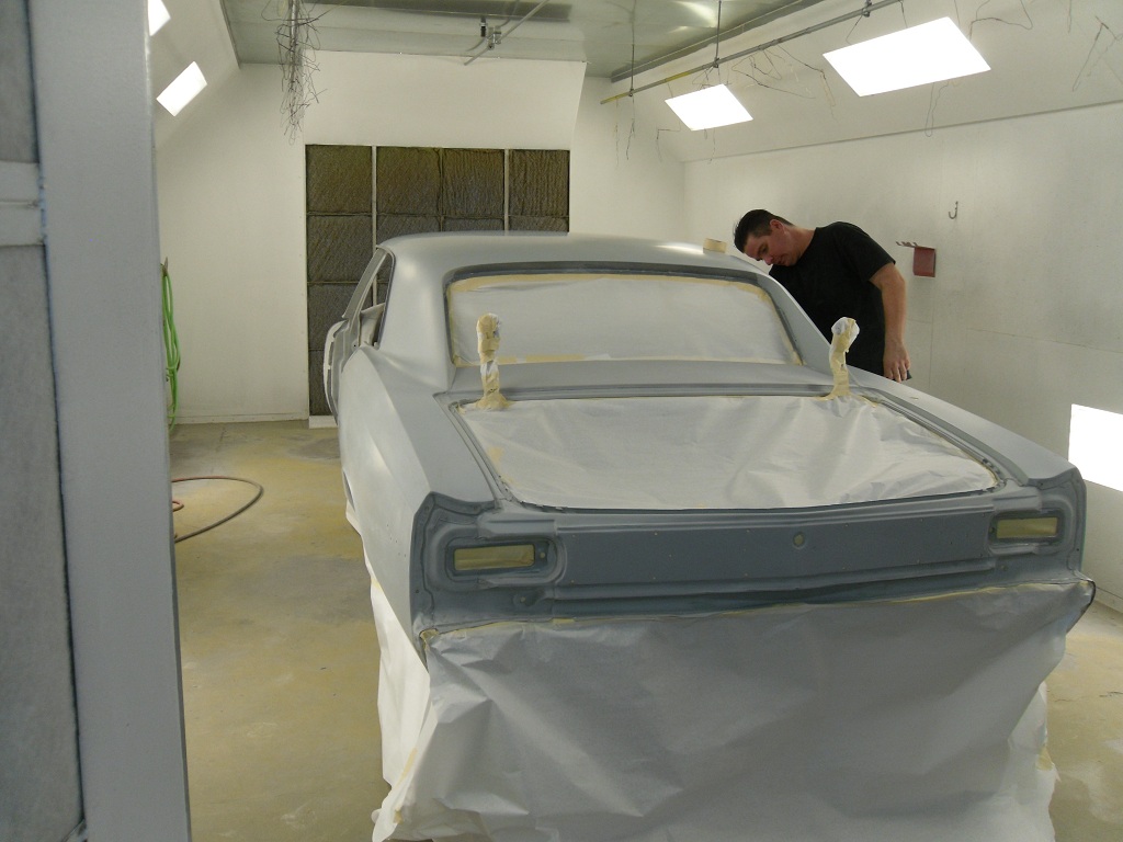

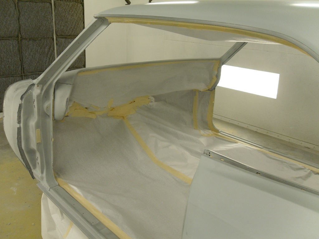

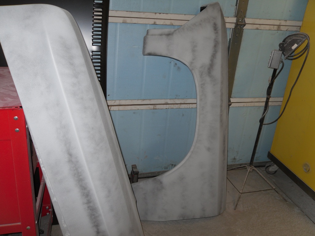

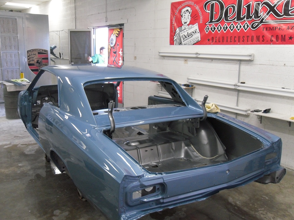

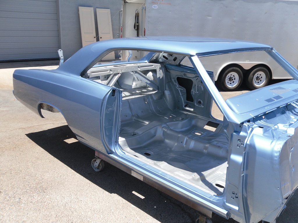

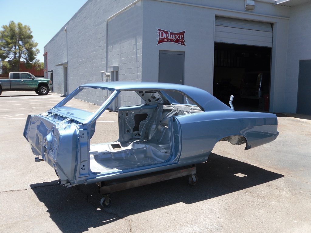

After sending the body to get powder coated ( I did not get a picture of it after that was done it was off to "Deluxe" to get it straightened out. Also pictures of the frame before, after we boxed it it, and reinforced it for the roll bar.

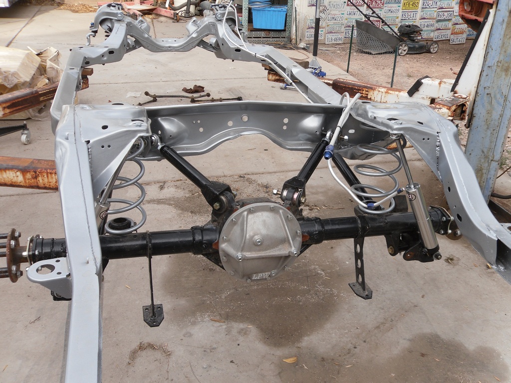

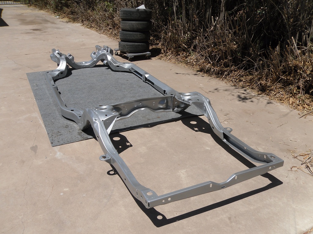

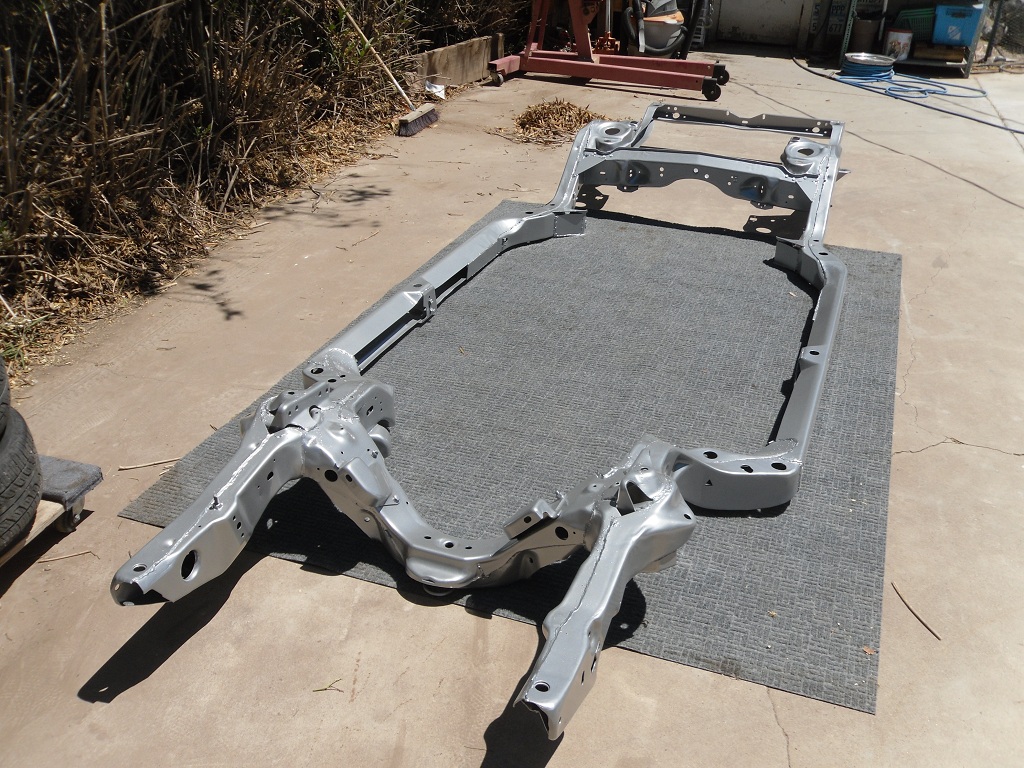

The Frame is back from powder coat and things are getting ready to get pretty....

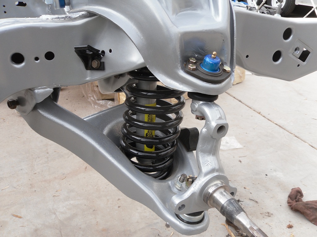

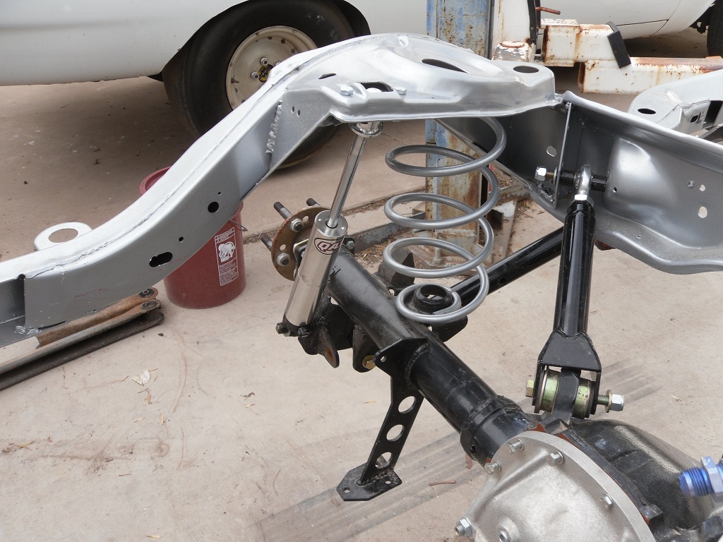

After the frame came back it was time to put on some pretty stuff.

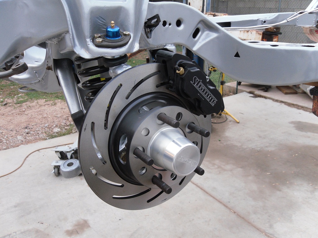

Went with ALL Strange Engineering components. 12 bolt (all Lite) Front and Rear 4 piston disc brake system. Global West bushings, Spohn Rear Arms and Anti Roll-Anti Sway Bar. moroso Trick springs (to start) QA1 Stocker Stars out back and CE' up front. This will be the start point as I am sure I some stuff will change later.

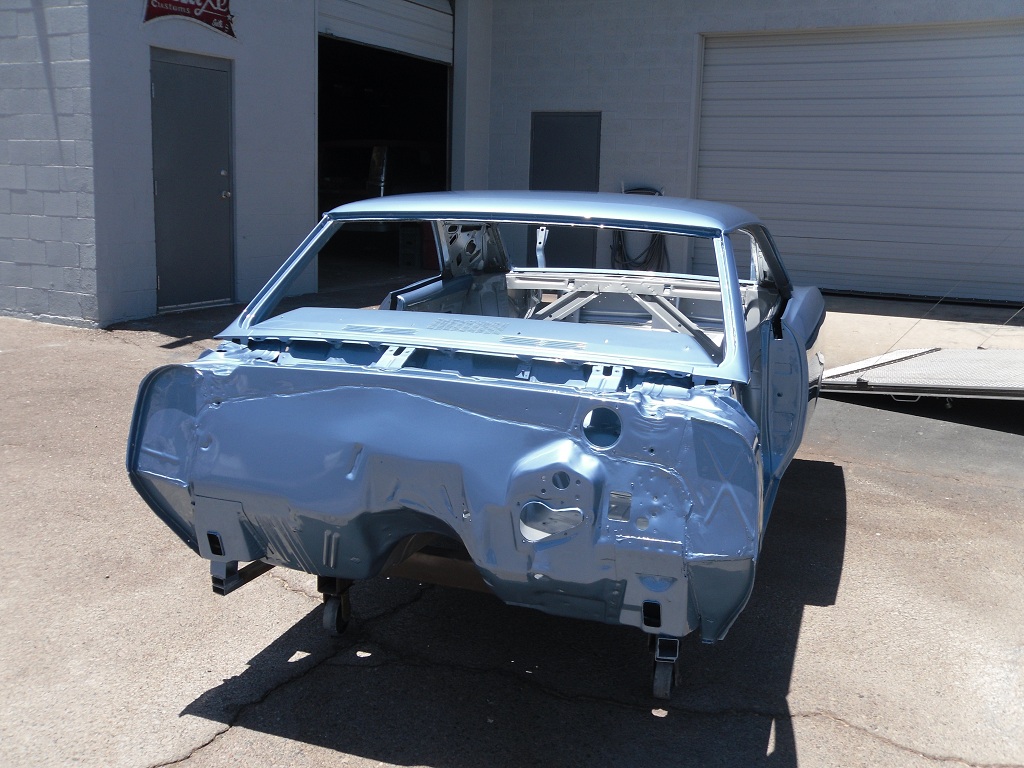

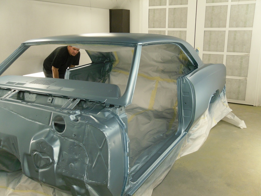

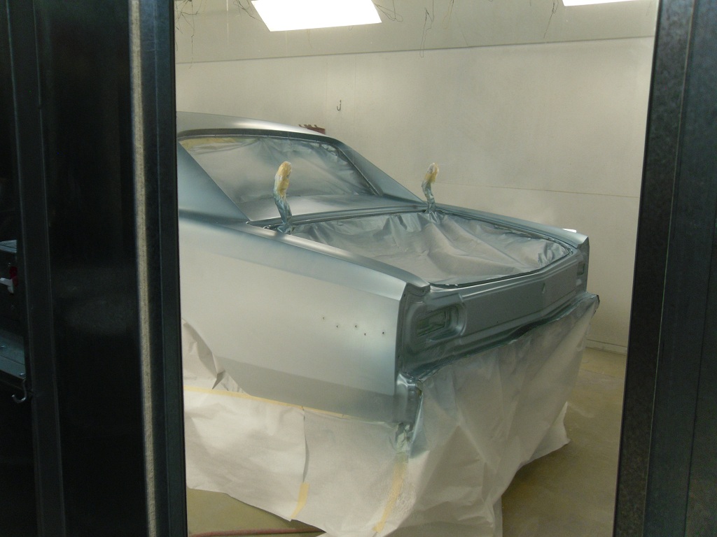

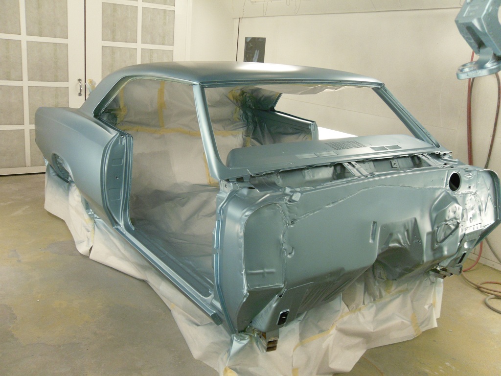

Now this is the Base Coat. Its weird how the lights affect it with out clear on it.

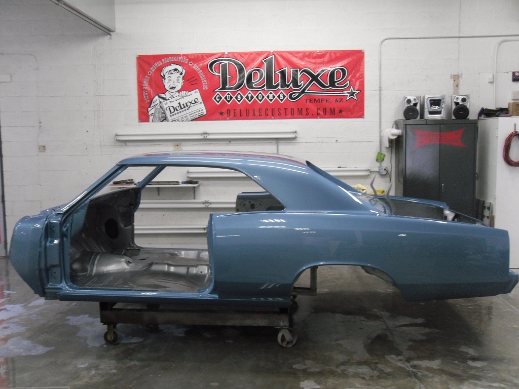

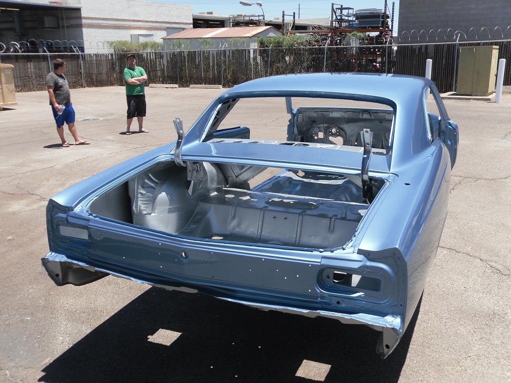

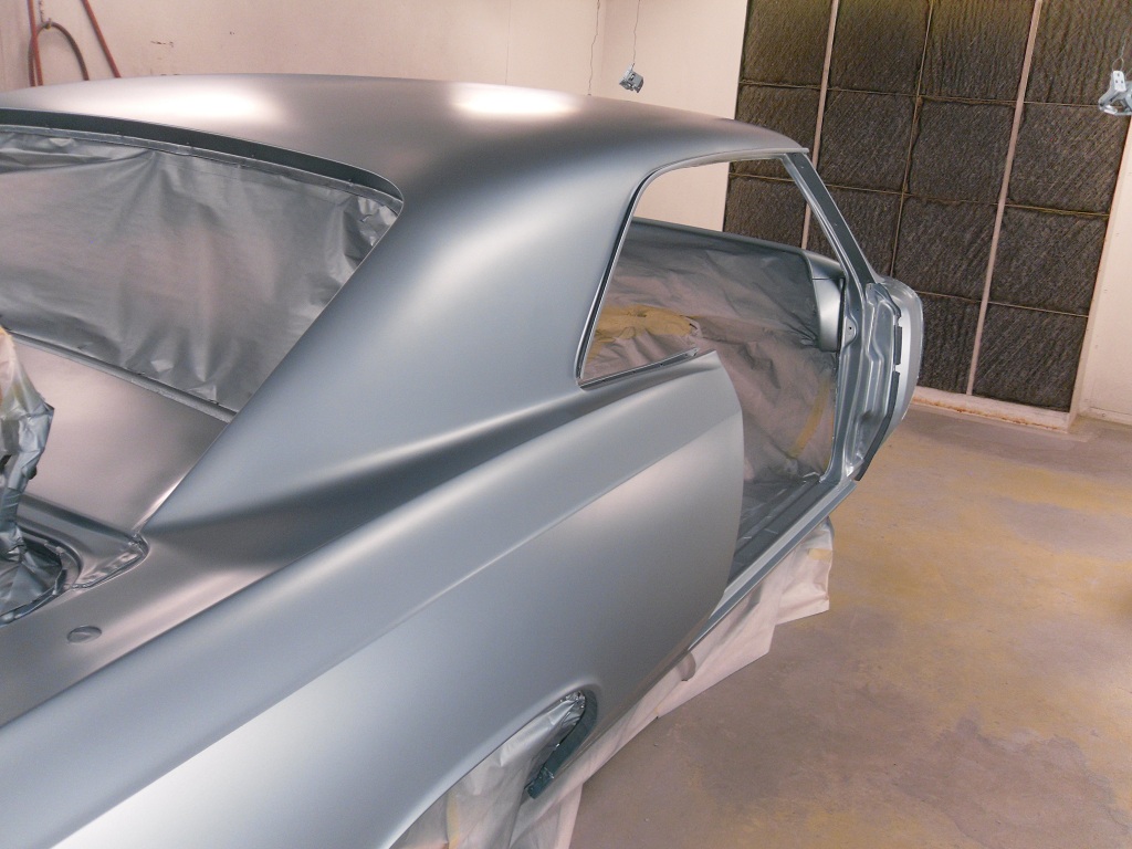

Now its Shiny again! Special Thanks to the Howard Brothers for this part! Stopher and Matt put alot of work and detail into this for me. They normally work on only high end european stuff.In these photos you can really see the contrast between the powder coat silver and the blue paint
