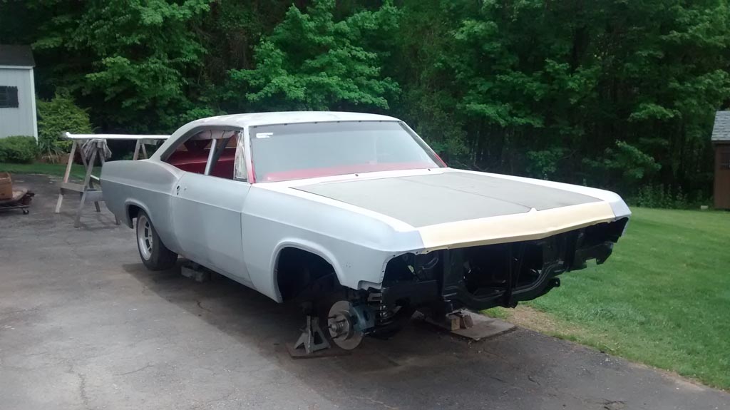

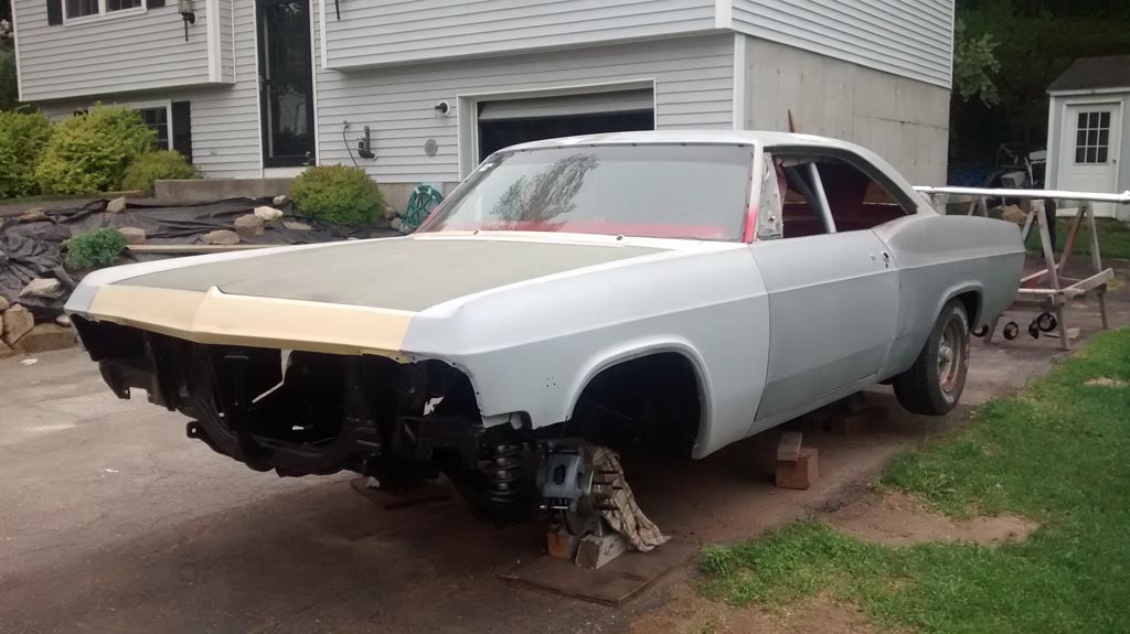

Here is pic of car today. I am missing passenger side front fender extension plus I really need a new trunk which I have one on the radar I will be picking up couple weeks.
