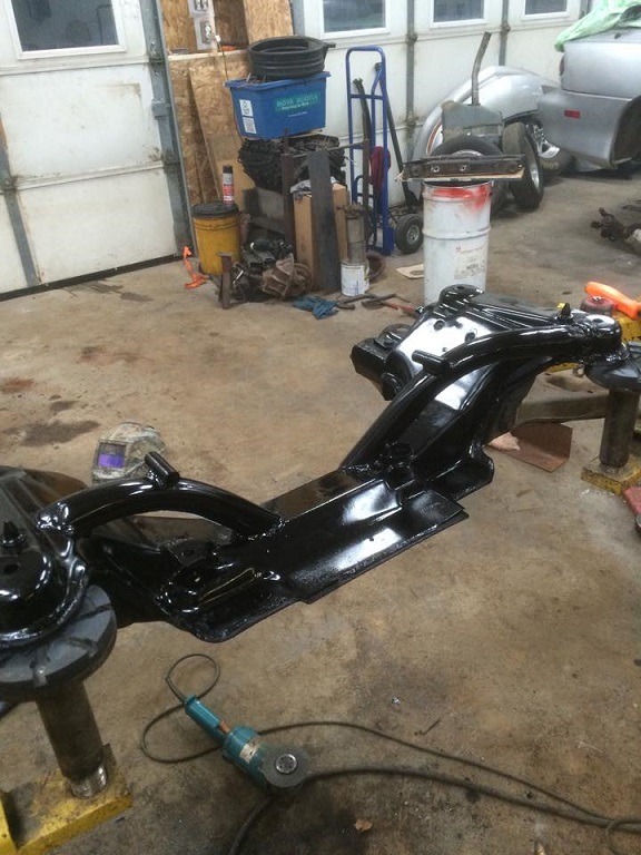

We are in the process of a neat build for my dads last race car. He had pretty well everything to put together a 71 LS5 454 engine, 365@355hp. The engine is mainly used parts aside from a new set of Eagle rods he got a deal on. The budget build of about $4k netted us 465HP @ 5500 on Armstrong's dyno, we were quite pleased! He had wanted to build a chevelle to put it in but being a retiree they are out of budget for him, well actually just about anything was but we still had all this gear around. I decided to pay him back for helping me get my first race car about 15 years ago, but running a stocker myself, a second chevelle was out of budget. Sooo onto his second choice I surprised him with a trip to North Carolina for his 65th birthday, to purchase a 97 camaro roller that we would make his last race car from. The combination is a natural Stock GT/A but we plan to run it in B, with a minimum weight of 3365#, and on an index of 11.65
So here we are about a year later finally with enough gear rounded up to make a race car and we've been able to make some good progress.

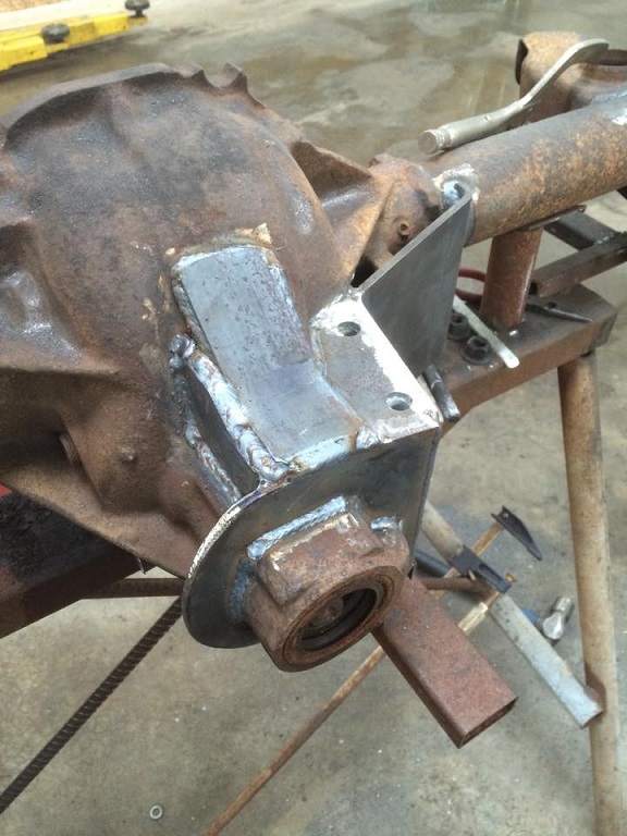

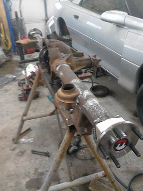

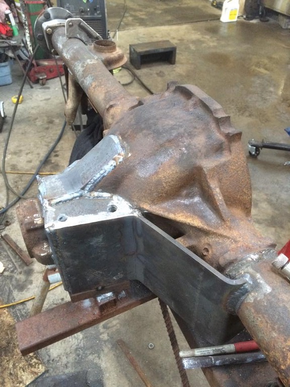

It was going to cost too much for us to go with a 12 bolt, so having lots of time we resorted a route we used for a few bracket cars. Starting with an 8.5" 10 bolt housing we transferred all the brackets and fabbed the torque arm mount, and added a Moser spool and axle kit, along with Motive 4.10's.

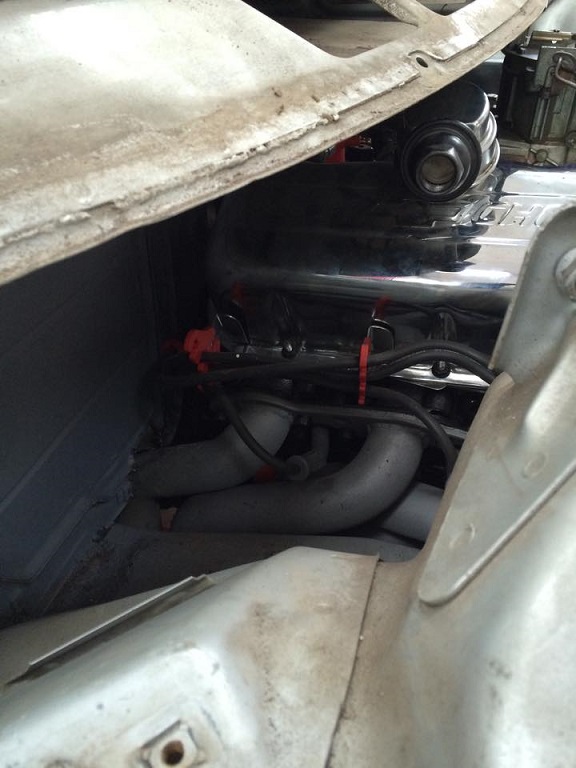

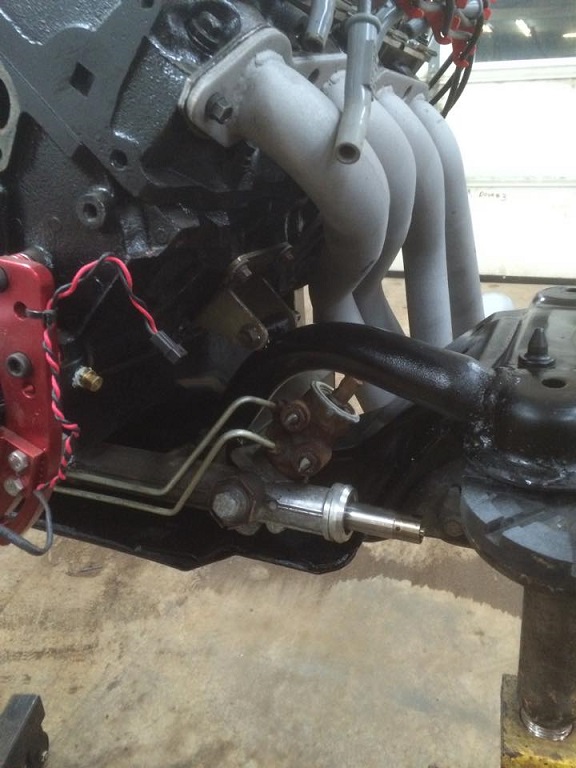

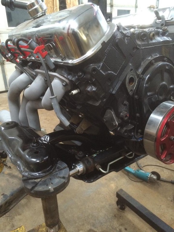

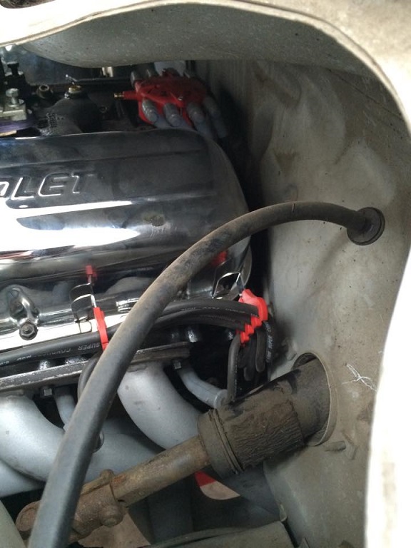

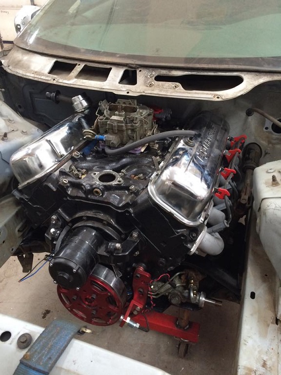

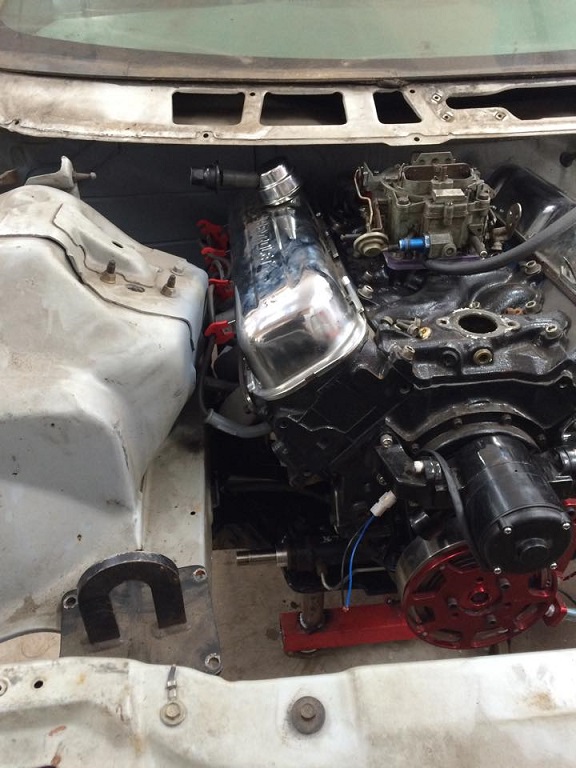

Again cost being an issue, the only specific swap headers I could find were Lemons, no way. After much searching and measuring it was decided a set of Hooker chevelle street headers would do with minimal reworking. The rack posed an issue as the pinion was going to run into the mount and header, but a little more searching paid off. I found that the LS1 cars rack had the pinion laid over tighter to the frame rail which gave us the room we needed. All in all it wasn't a bad swap! The biggest problem and decision we faced was the distributor being under the cowl, and not enough room for it. Well the rulebook stated that any vehicle (key word!) factory equipped with a distributorless ignition could run crank trigger, so thats how we went, and it fits! I'd like to have some more carb clearance as I think it's too close at 1" from cowl, about 1.5" from bottom of hood. But pan is only a 1/4" off the rack so not much we can do there.

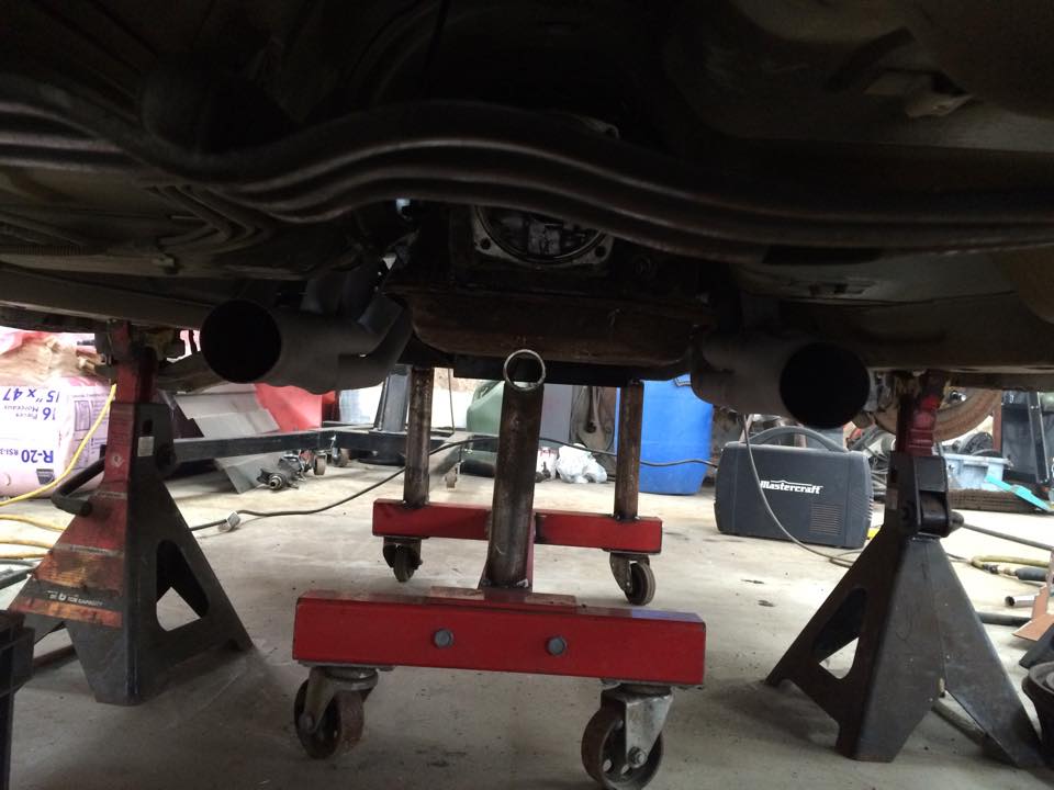

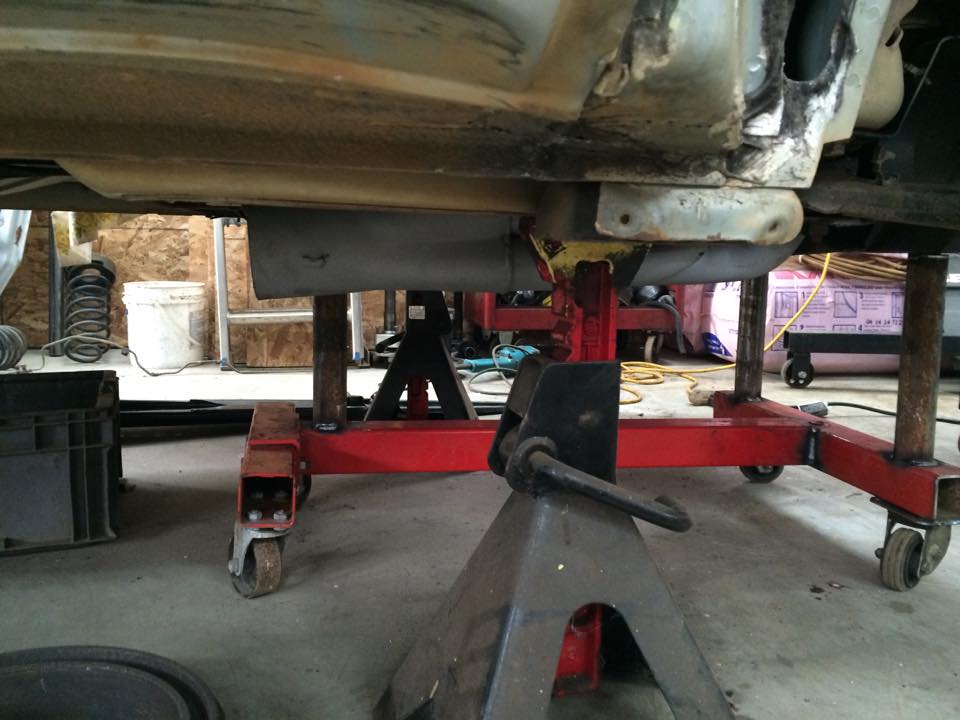

K member with mounts and engine installed. Made myself a little cart as well for frame, engine and trans to rest on so that Installation is easy with the hoist

I realize that you were very clear regarding cost , however , the rearend will most likely be an issue . My personal experience , and that was in a lower class stocker , is that it won't hold up. Do yourself a favor and install a 12 bolt .
Brian Fink is offline   Reply With Quote
Old 11-21-2015, 07:13 PM   #6
MR DERBY CITY
Join Date: Feb 2014
Location: Derby City, USA
Posts: 3,607
Likes: 1,067
Liked 7,780 Times in 1,494 Posts
Default Re: 1997 Camaro SGT/A-B
X 2 on the 12 bolt...that Big Block is going to scare the hell out of that 8.5.....

That's some nice welding. Would be inclined to agree about the 12 bolt but I'm a Fffffford guy.
