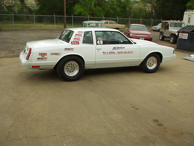

117X,
this is why I know about G body steering
Larry Woodfin 471W

Larry,
That's a nice looking car you have there! Thank you for the clarification. I was understanding correctly; just wanted to be sure. Now I search...
