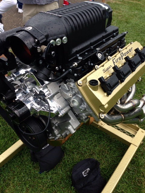

Supposedly there will be 2 different 2015 Drag Paks. 1 N/A and one supercharged. Not really "Hellcat" engines, but badder. Rumor is the factory rating is 290 HP.
