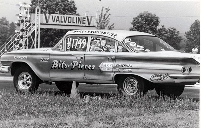

As I remember, the official rule came about after the 72 Spring Nationals...
Jim Kronenbitter (60 Chevy, SS/X, 283 , 2bbl) was runner up to Bobby Warren.
The car was air bled so bad, it was popping , banging and wheezing all the way to the final round.
Everyone thought there was something broken in the engine.
He managed to take out a few of the Chrysler factory backed cars along the way, as I recall.
You just didn't do that back then with an independent Chevy ,without causing trouble.
Hence the new rule banning intentional vacuum leaks, shortly hereafter.
