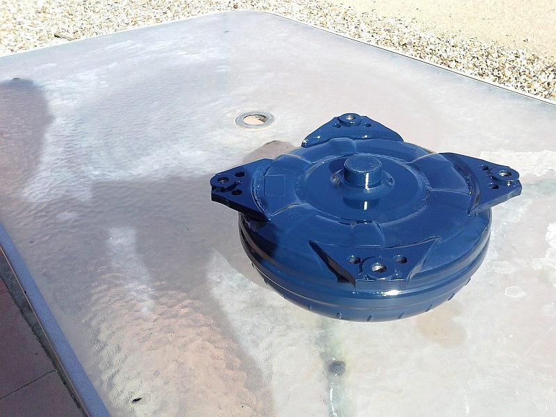

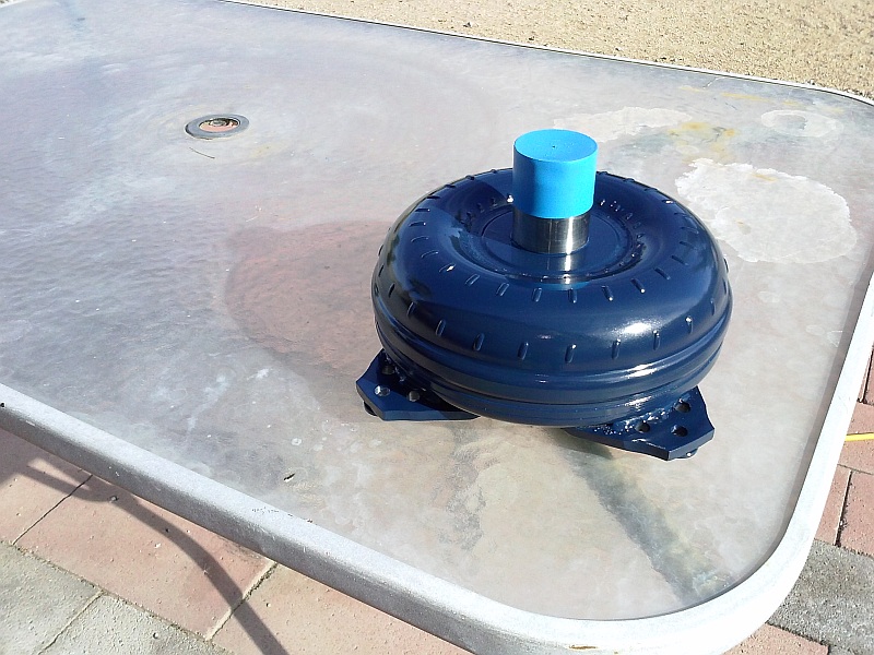

This is the first one done , of several ordered for the 302 2V NHRA gift combo..
This one to be tested in January, hopefully
I got a few lbs out of it by cutting away most of the mounting ring..Down to 17 lbs now
I think I can get another lb. or two out by thinning down the tabs some more, and the pilot plate, on the next batch..

Mark........is that a 7 or 8inch converter?

Marty, That's an Opel style 8" reproduced with all new parts.
I don't believe a 7 inch would work in this application..Not enough rpm's due to the 2bbl restriction.

Need to know if it's carbed or EFI.
I have built several of the small bolt pattern 4 cyl converters.
There's a possibility of a 7 " working in a turbo car, in that you could get the rpm's higher on the line and leave with more boost.
The trade off would be on the other end, of course.
Maybe backing off one number on the gear ratio would bring the mph back
You know that the smaller the converter, the higher the price though...
You'd have to do the testing now
I never got around to it with mine, but I did kick it around a bit in my mind.
