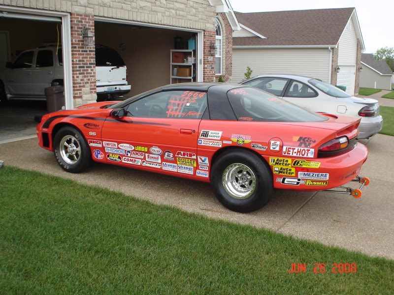

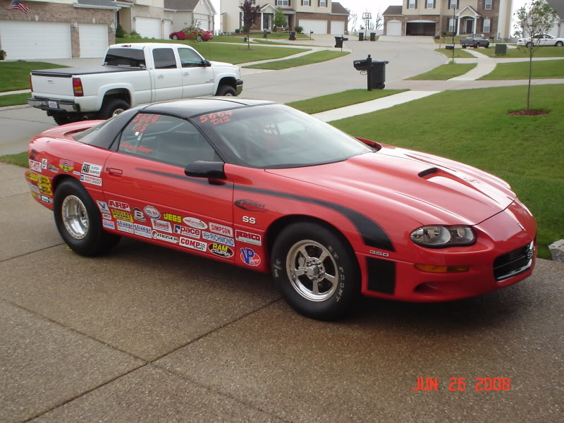

Larry on a stock width rear a 15x10 with 7.5 backspacing is very common. I had a 15x10 with 8 inch backspacing that tucked it in a tad more and looked great. In the 8 inch backspacing wheel, it would have to be a bogart or holeshot wheel to get that specific 1/2 inch increment backspacing. Where 7.5 backspace is common on any wheel

Is the wheel you are describing this wheel, in the photos...
the front space looks Deeper than what you are describing?
