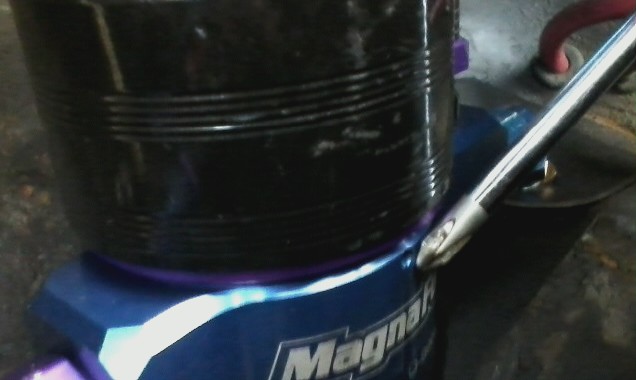

new fuel pump has a leak from time to time is this a weep hole? this a sign of internal problem pump is less then month old

Internal problem with bearing and/or seal. Had the same problem recently. There should be no fuel at that area.

CALL Magnafuel tell them your symptoms they are very good about standing behind their products--FED387

Get the parts and fix it (bearing and seal)
The gas washes the grease out of the bearing and it WILL fail!
