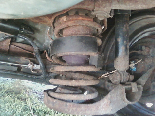

Now performance wise. We've put a set of M/T drag radials on the car, air pressure was 38lbs for this series of runs. I also put a set of spring rubbers on the rear to stiffen the car up. Art Leong, if you read this, used your Funny Car burnout routine. Wasn't impressive but did put a little heat in the tires. I was very happy with 60 foot times, they improved from 2.5 to 2.4's, not great but a gain none the less. It felt harder on the launch.

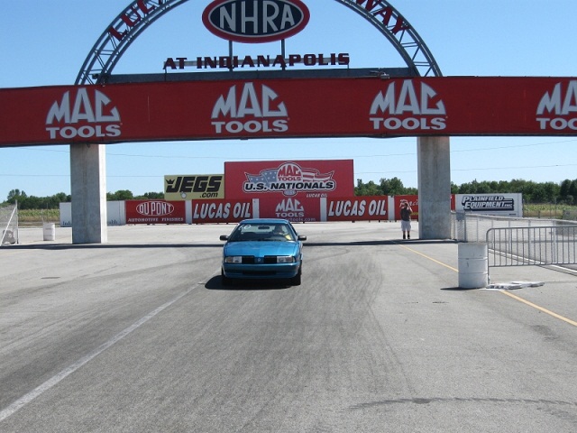

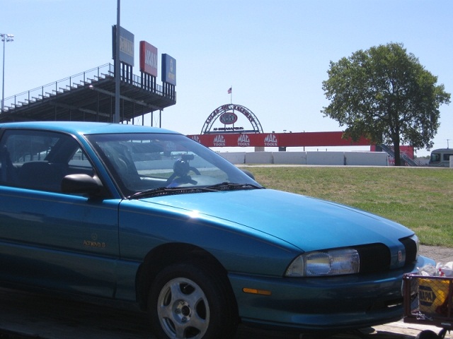

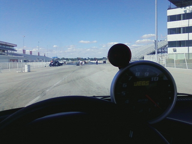

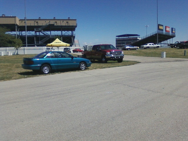

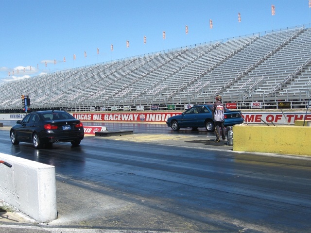

Name:	Acheiva on trailer at indy.jpg
ID:	13029   Click image for larger version
Name:	IRP westside pit.jpg
ID:	13030   Click image for larger version
Name:	starting line view.jpg

Name:	spring rubber.jpg

Yeah, addictive to boot. Got good bang for my buck on this trial. Afraid the next step is gonna take a little more. Think I'm going to stiffen up the rear with another spacer..
