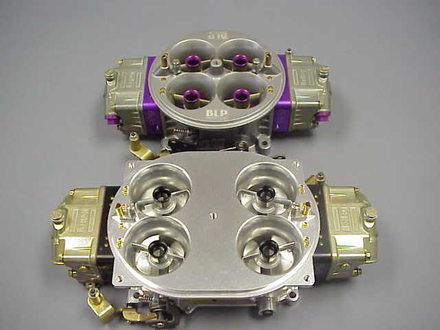

You could always try one of these... Currently on the 673 Sonny's engine in Mike Laws (BLP President) Top Dragster. 6.70's in the 1/4 with one carb N/A. It can be duplicated with a standard bolt pattern billet body, this on has 2.600 throttle blades but can go up to 2.800 on either the spread carb as shown or a standard Dominator pattern. Intake work required for either, if you have a sheet metal a top for either isn't too hard to do.
www.blp.com
