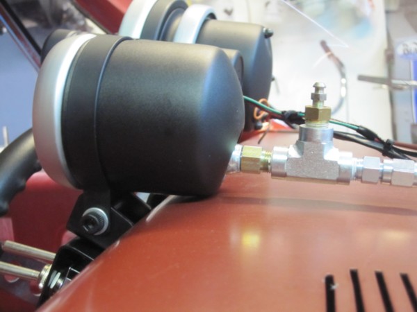

See the attached photo. I used a vacuum bleeder to help bleed the line up to that point at the guage. Less messy too.
