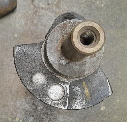

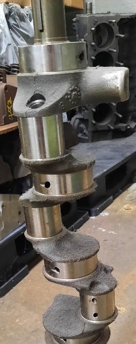

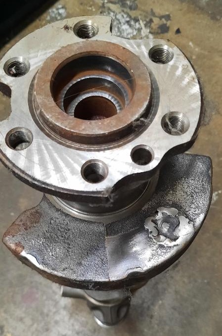

Duane, NOT being a smart*** about this but did you ever see a 301 Pontiac crankshaft?
Here's a 301 Pontiac stocker crank internally balanced!
