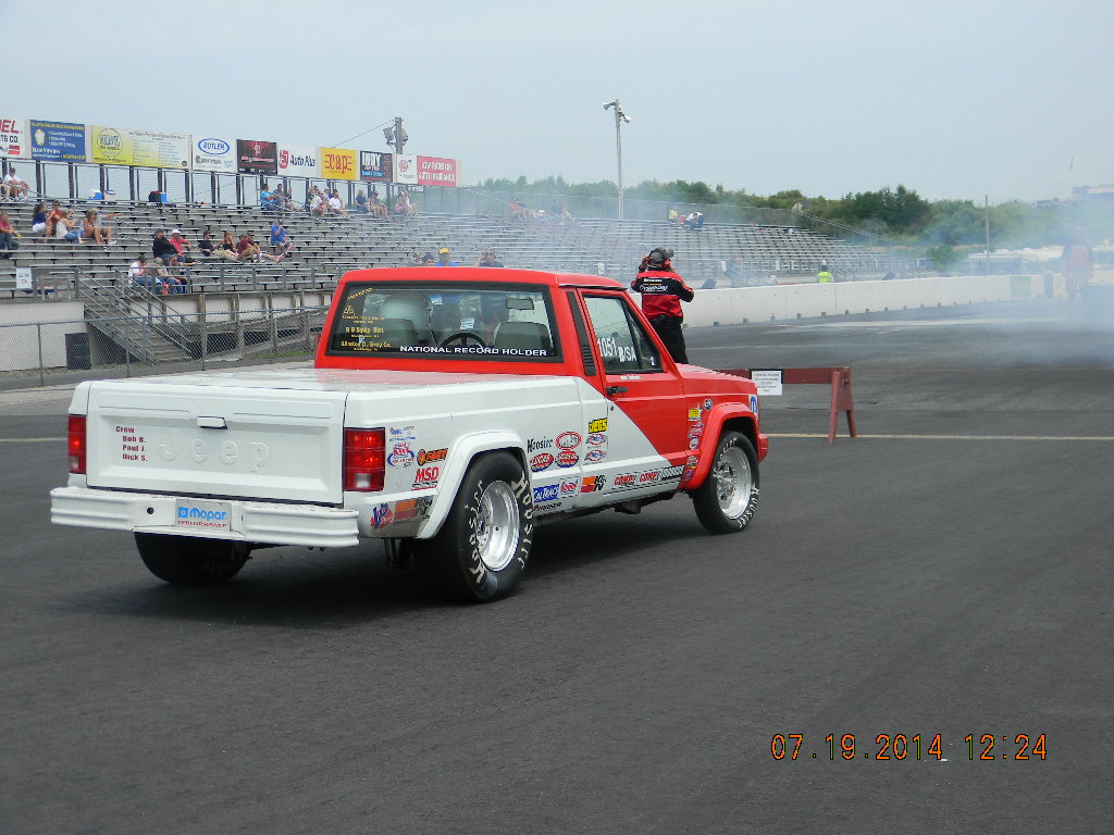

Having owned several of those 360 Cherokees/Wagoneers. you should know that they are HEAVY!! Also as you already know - very little race equipment is made for Jeeps. The AMX's run pretty well with that engine type.
My Comanche is somewhat lighter/simpler with the 4.0 engine.
