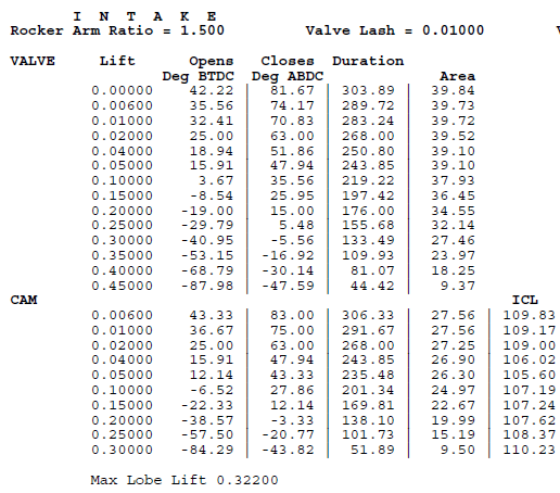

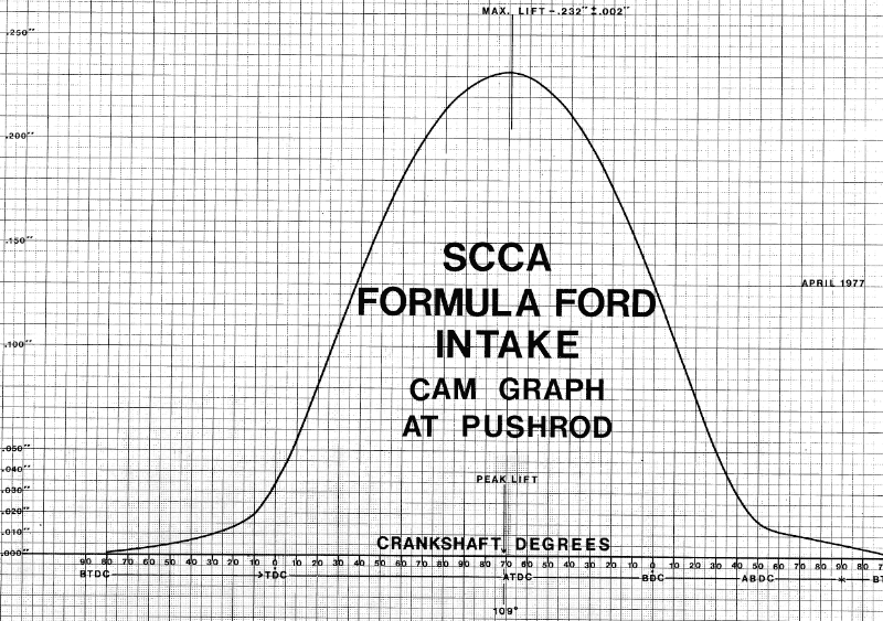

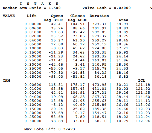

I don't have a dog in this fight. But it is just the results of NHRA not following their rules and then allowing rules change after rules change. If back in the beginning they had done like the SCCA you wouldn't have all of these problems.
Stan
PS I know it has been going on for a very long time. 50 years ago we were running a Lunati stocker cam in a '67 Z28.
The Chevy 3030 data is from a Cam Dr the Lunati data is from me with a degree wheel and dial indicator on a used cam.
