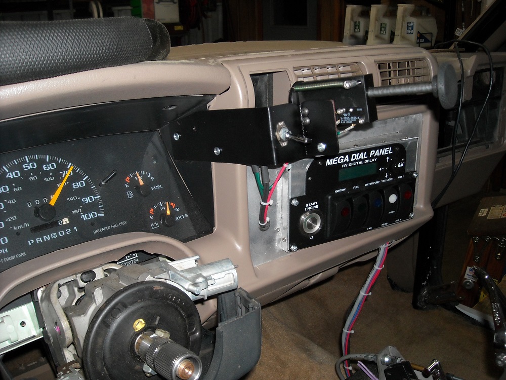

another example of small items that are very important and time consuming.
The photos appears to show the "just in time switch" in an awkward location but when seated it is just right. The mounting bracket is simply a piece of sheet metal cut and formed as needed. Not visible is a triangulation brace leg on the right side of bracket.
The toggle switch is a "burn/race" switch. Down is line lock only, up is both line lock and trans brake.

The wiring of line lock and transbrake together is not permitted in SS or comp eliminator.
Is that toggle a three position (up-on/center-off/down-on) master power switch for your line lock and trans brake switches? I have a similar setup on my Mustang using seperate master power switches for those circuits. They let me disable either line lock and or TB when I don't need them. Since the actual switches that activate the LL and TB are seperate, I believe it's OK tech wise.
My car's street legal so the wirings a bit of a rats nest with all the turn signals and such running off seperate switches, so tech will have a fit with it anyway. At least I labeled everything.
Dale
Dale
It's not okay. Like Fred said earlier, there must be wire and circuit separation separation to both the line lock and transbrake. Tech will check and trace the wiring for separation.

No problem about the trans brake - line lock activation. I will change that. Doing so is common in bracket racing so I should have doubled check the rule book.
