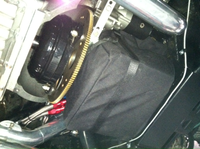

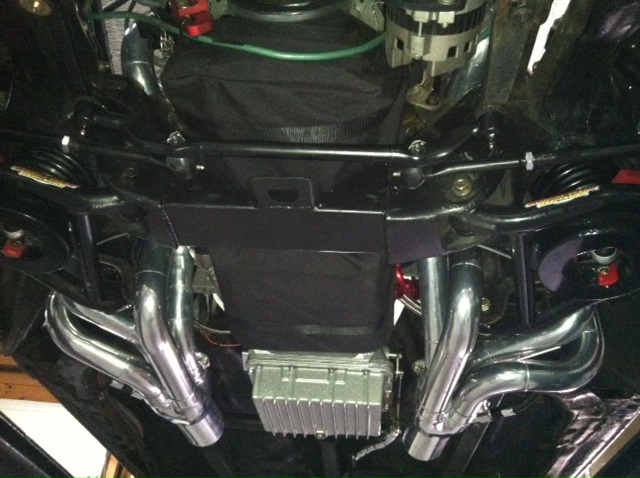

Robert Pare Racing
Robert Pare Racing's Avatar
Join Date: Aug 2004
Location: Mother Earth
Posts: 265
Liked 2 Times in 1 Post
Default Re: Diaper required at Division 1 Tracks?
I think I have a little more than $169.00 invested. I had to make some rather extensive mods for the diaper to perform properly, but I am glad I did it. Athey race cars did it, actually, I don't have the ability or know how to do any of this. Custom billet oil filter remote, etc.
