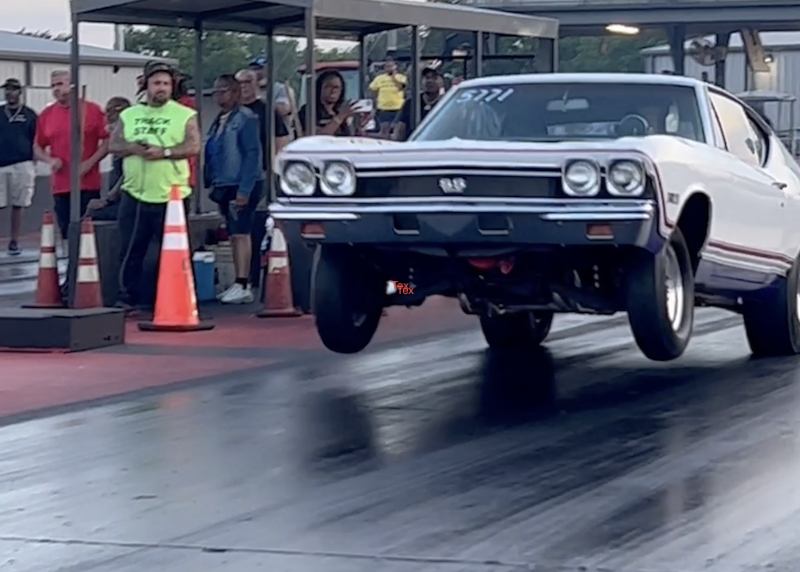

Test is done.
80+ degrees
70% humidity
59 GOW
29.30s baro
459 track elevation
15 MPH strait on head wind
1.33 60 foot
4.01 330
6.31 660 (3 in a row)
106.29 MPH
3490-3500 pounds
Name:	wheelie 2 copy.png

Three 6.31's....I know you want more but I'd be happy to bracket race that!! (of course, then my bad lights are more obvious when I have a bad package) LOL

What kind of exhaust. It?s a nice well working car I see.

Thanks, 2 inch Hooker with 8 inch extensions.
