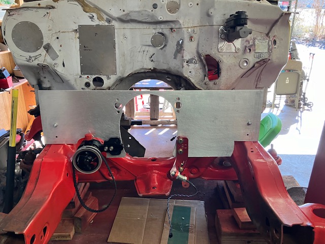

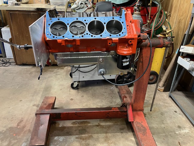

Switching over to engine assembly and related components. the firewall forward to mostly ready for paint.

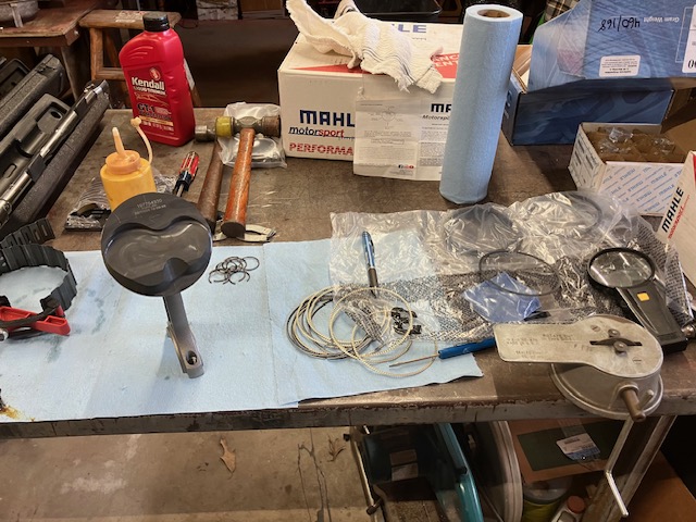

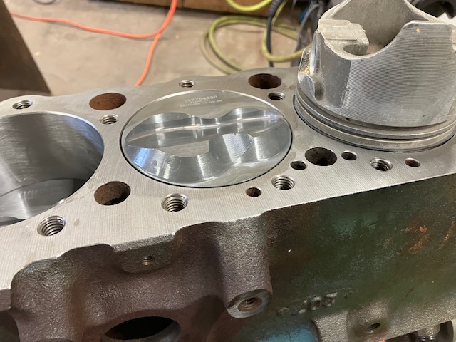

Around twenty years ago, I considered replacing my old sealed power manual ring grinder with an electric model. Each time I would consider doing so, I would convince myself I would only do a few more engines, so I would get by with what I have. Well, now I am age 77, and it is a slow, tedious, time-consuming task with the old manual tool. But I will only be doing a few more engines. Old fellows, old tools, old ways that define me. I average about 45 minutes per cylinder to gap rings, assemble the rod to the piston, work with the pin clips, and install the piston and torque rod. Then, a break to look things over, ponder, daydream, and perform other necessary duties. So, it is really an hour per cylinder. And this is with everything already clean, already checked, and everything laid out.
Also note my 50 year old ring squaring tool.

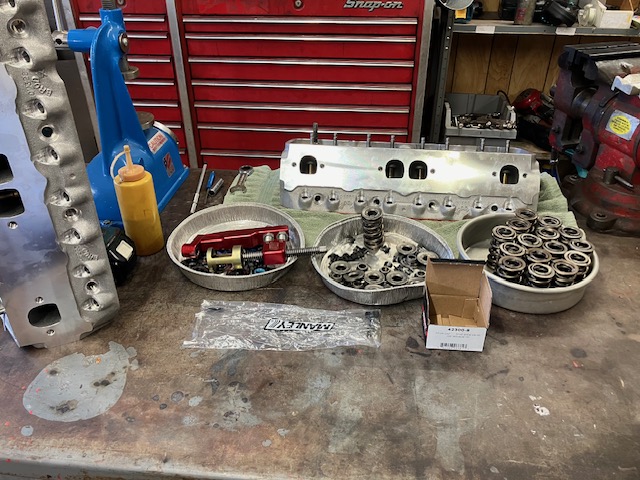

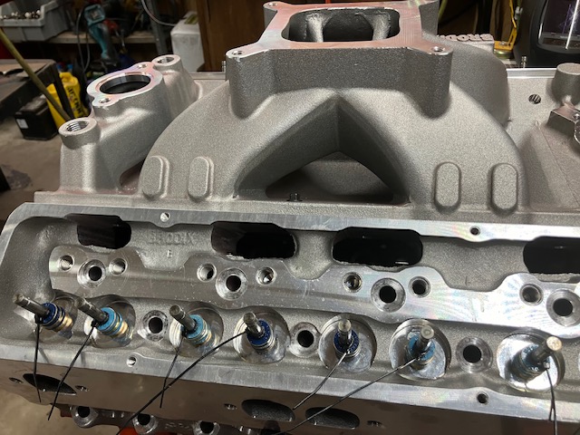

I have been known to say I do my best thinking, err, hallucinating when mowing or driving. Since it is the off-season for mowing, my thinking is confined to driving.
The following photos show my revolutionary design to replace valve springs. The idea came in a dream, spawned by the toughness of cable ties. The tails are located outside the valve covers to allow tension adjustments.

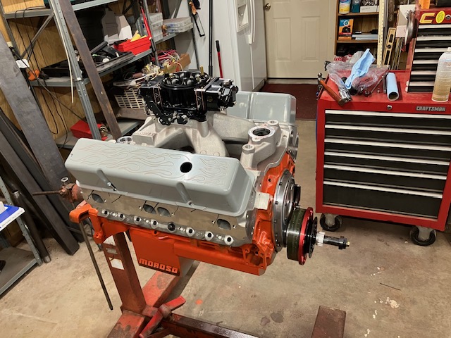

progress

Just curious, is that a oil temperature gage line in the oil pan or is it a line for a oil heater? Thanks

Greg, it is the power cord for the oil heater. It's a Steff's item. This is my first experiment with such an apparatus.

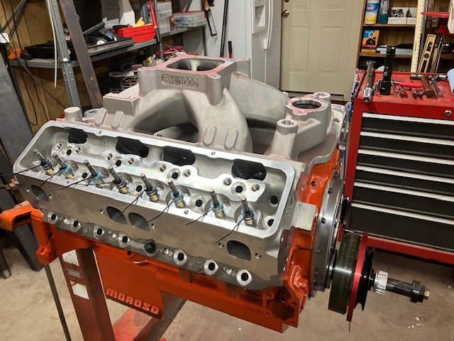

A fine Monday afternoon to all. Be sure to notice the 5 - 7 crossfire enhancement.
