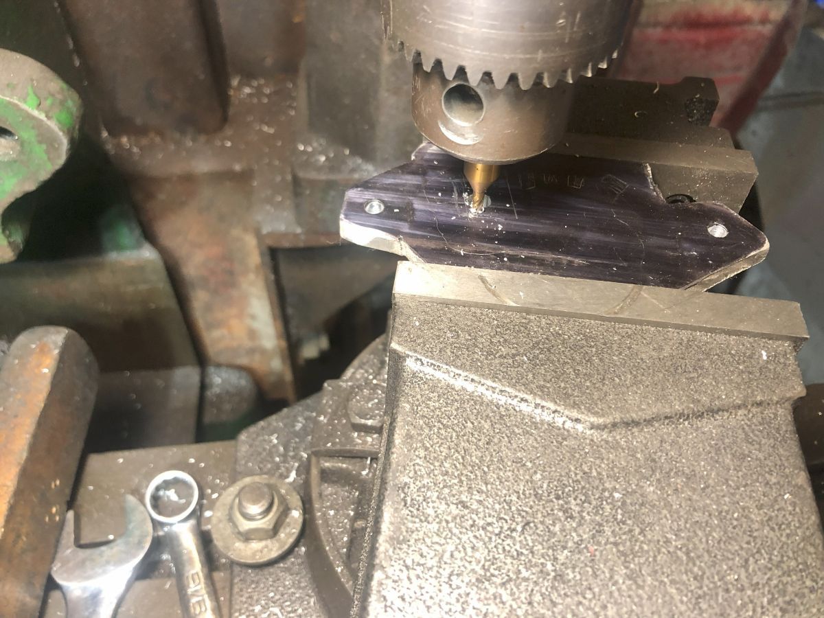

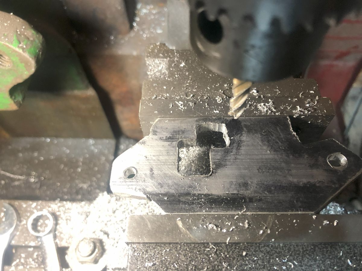

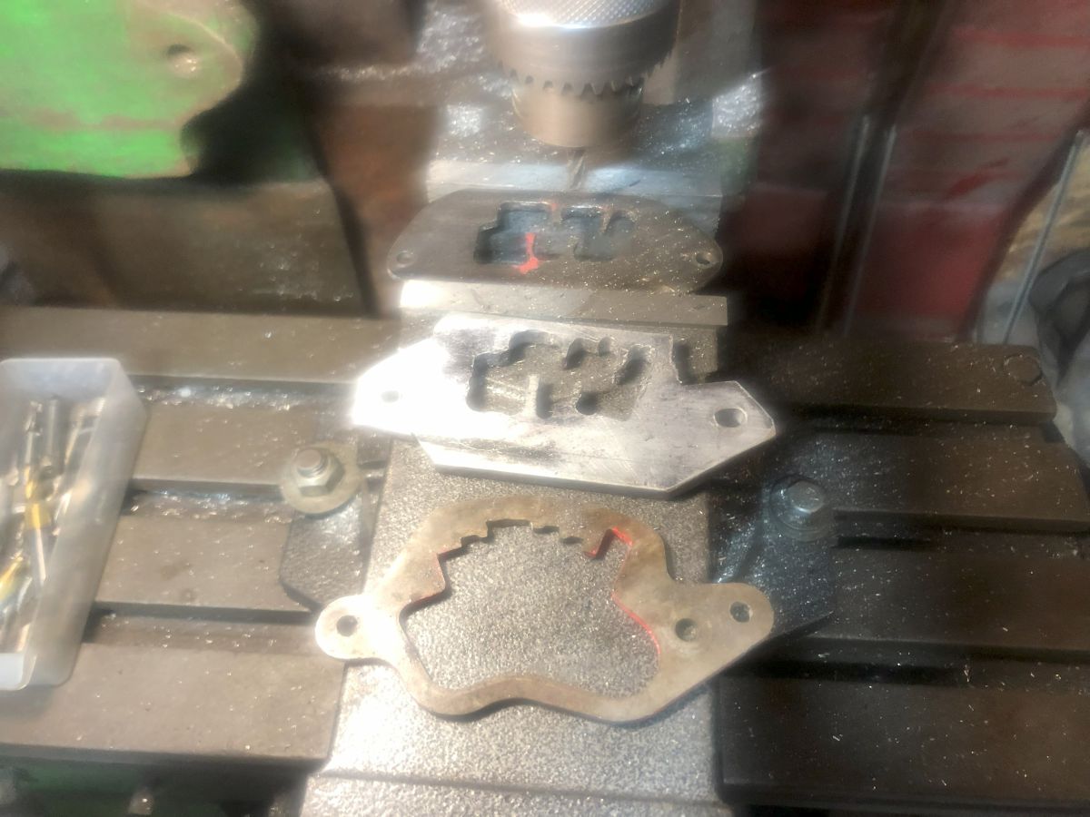

But, in between a million other things, I decided that since pulling the reverse pattern valve body 5 times, went over it and over it, took it to a performance transmission shop and still.....no bueno. So, put the forward pattern valve body back in (with the shift kit in it) and was going to rebuild/replace the b&m shifter or the hurst or something to work and instead said why do it the easy way, LOL!
So instead, since I have a milling machine, I made my own shift gate for the stock shifter. Now thumb button in, first to second, button out, second to drive, in, out, in, out from 1st to park. Made a template out of aluminum then transferred it to steel.
Again, mechanic, not machinist, lol!
