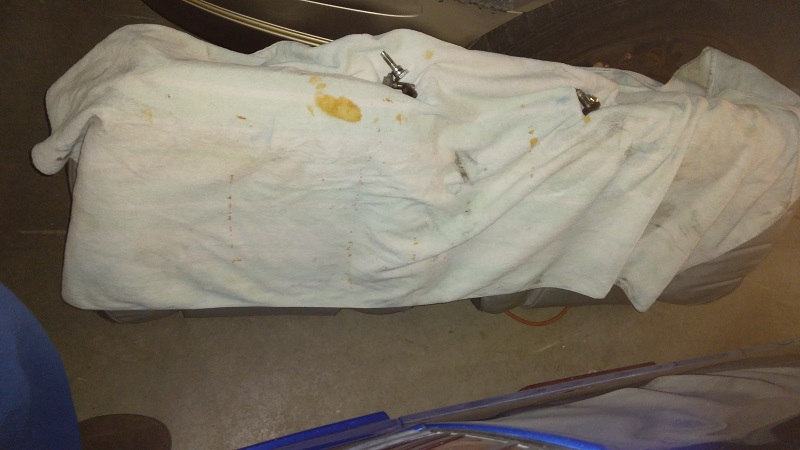

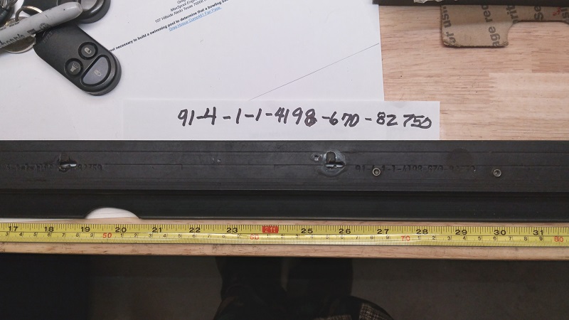

I actually started with the passenger side auto window that was sticky, pulled door panels off cleaned away all the old hardened grease on the rails, sprayed w/ silicone lubricant, and both slide like new again up and down. And measured up for a passenger window outer upper belt window scraper I damaged attempting to get that slow passenger window up once in a hurry. Have not found that replacement part quite yet but a line on a few new ones.Click image for larger version
