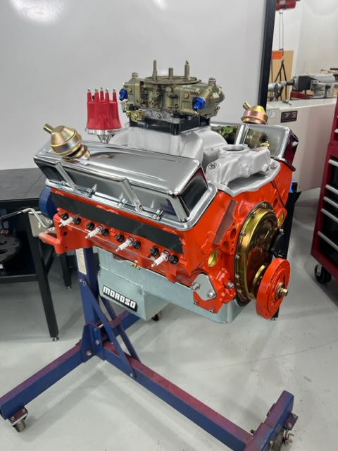

So I started my 350 build, .060 over 2 bolt 010 block, I did some work to the factory cast crank which ended up @ 3.483 stroke, I put a 6 inch rod in there with a + 6 cc dome Mahle piston, my Fuelie heads came in at 74 CCs which gave 10.8 compression. My solid lifter cam was .528 lift @ the valve with 264 @ .050 duration on both sides, 108 lobe separation. I used a Performer RPM intake with a 750 Holley, the Moroso pan was modified.

A picture of my new 350

The 350 with 4 passes delivered the following performance in street trim with the power steering and steel two piece drive shaft @ 3970.
1.50 60 foot
7.04 660 @ 94.2 MPH
