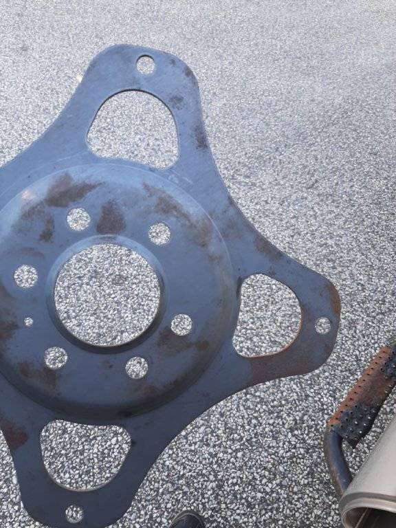

Default Re: SFI flexplate mandatory in all v8s Jan 2024
Looks like about twice the flex plate that a lot of the Mopar guys are using, and still doesn't address the supposed problem...The ring gear :-(
Very true, the one on my car looks like this, I got it in late 74.
