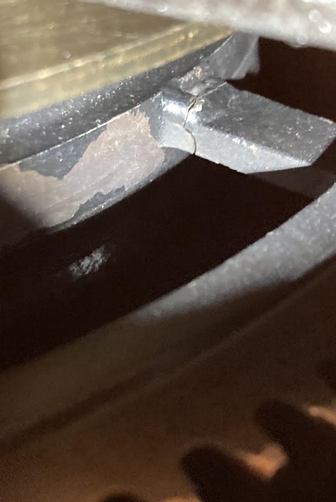

Has a Mopar torque converter ever lost a ring gear?
And That's Ironic…this photo was sent to me last week...
Edit...had pic problems.

If it saves one driver or car incident it’s a good rule. Those guys were very lucky..

As pointed out to me;,stick cars have had SFI for a very long time so it’s only fair flex plates follow. We’ve had SFI flex plates show separation between welds in the ring gear. The starter tipped us off. You could hear the difference cranking. That was 6 years ago ( or more) and we’ve replaced flex plates / brands since then.
Stock flex plates weren’t designed to see 6 K time after time let alone 7500 or 8.
