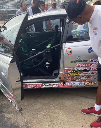

Here are some photos. This could have been REALLY bad. I have an unconfirmed rumor that the back of the crankshaft broke off. I'm not sure if this is true or not.

I was in the barn when they pulled the trans.
Crankshaft was not broken. What remained of the flexplate was still bolted with all bolts to the crank. Approximately 2/3 of the flexplate was still there.
Parts of flexplate and ring gear were gone. The Trans case bell and ears were broken off.

Bashum started his burnout & the flywheel ring gear came apart.
I have a inch & half piece that I picked up.
Went through the 1/4 panel & busted out the right side 1/4 window.
Could have been worse.
