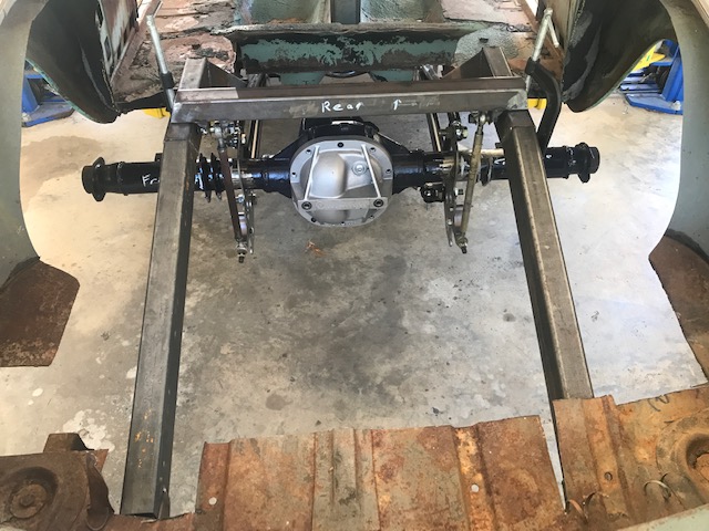

I am satisfied with the rear section work.

Curious. Instead of all that work on an 8.8 " Ford, why not just get a complete 9 inch?
Seems like a lot less effort. Love the car
