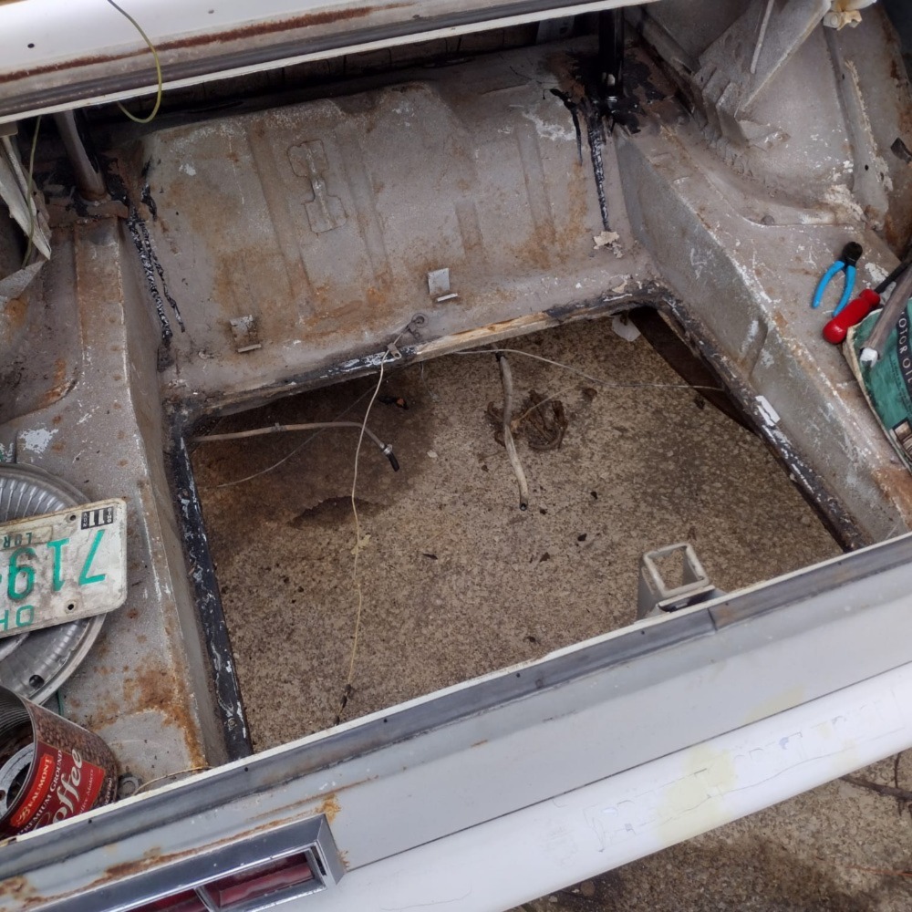

Fuel tank is out

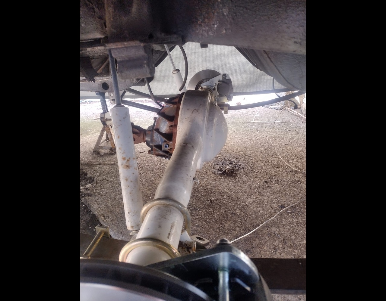

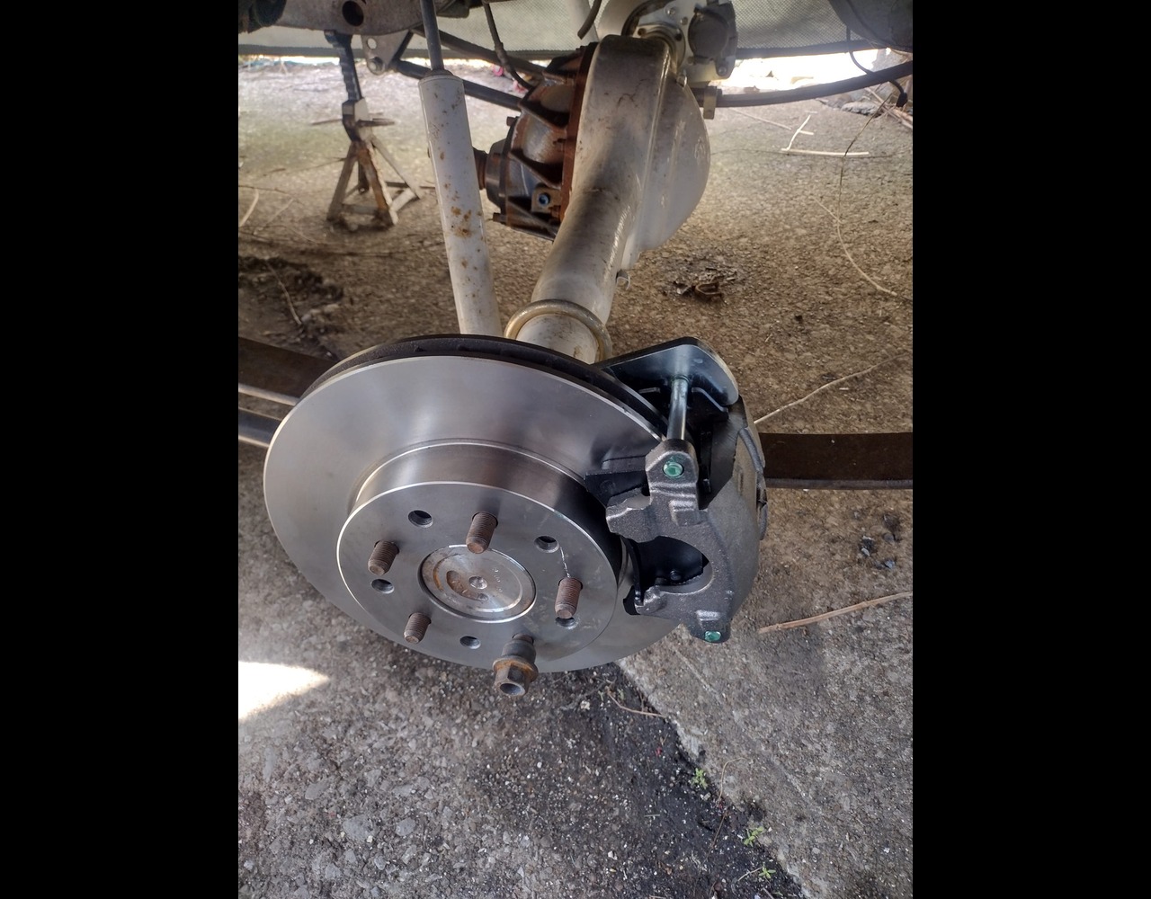

Jegs Brakes are on...just gotta install hoses,lines and proportioning valve
