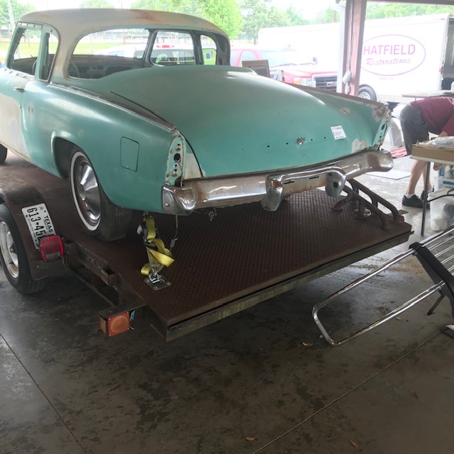

With the announcement of IHRA's new ownership and the promise of amping up sportsmen participation, and am encouraged to build a package that will run the 10.90 Hot Rod class. So, the build target is a package that will run in the 10.40 range. I hope that my performance goal will fit somewhere in the new IHRA program. IHRA has four valid tracks within my driving range so let's hope for the best.
The Studebaker will differ from cars I had done in the past.
*408 CI LS powered [details later]
*E85 fuel
*Three-speed trans
*It will be titled and registered as Antique
*It will be driven in parades and to car shows
*The front suspension will be OE Studebaker
*The rear suspension will be a long ladder bar with coil over's. The OE rear frame rails will remain un-cut. I will only remove the leaf springs and do some minor wheel tub mods. This will allow a 29x10.5 tire.
Presenting the "StuFin" or "WoodBaker" or ----------------?

The StuFin core

For the last week or so, I have been sneaking up on the ladder bar cross-member and rear shock cross-member placement. The fitment for both is tedious because the frame sides are not parallel in either area. I considered adding some plates that would make the fit up parallel, but after pondering, I decided it would be best to have the cross-members fit snuggly to the frame. So, I am about there, and since I have no timeline, all is well. Once it is all fitted and welded, and painted, I will post photos.
The rear frame and suspension work will finish in a few weeks, and we will turn to other areas.
Larry Woodfin 471W

Also, before removing the original rear axle assembly, I measured and noted the location for reference. And the original leaf springs are still in place, being used as an alignment fixture. Once all components are accurately located, the leaf springs will be removed.
Larry Woodfin 471W
