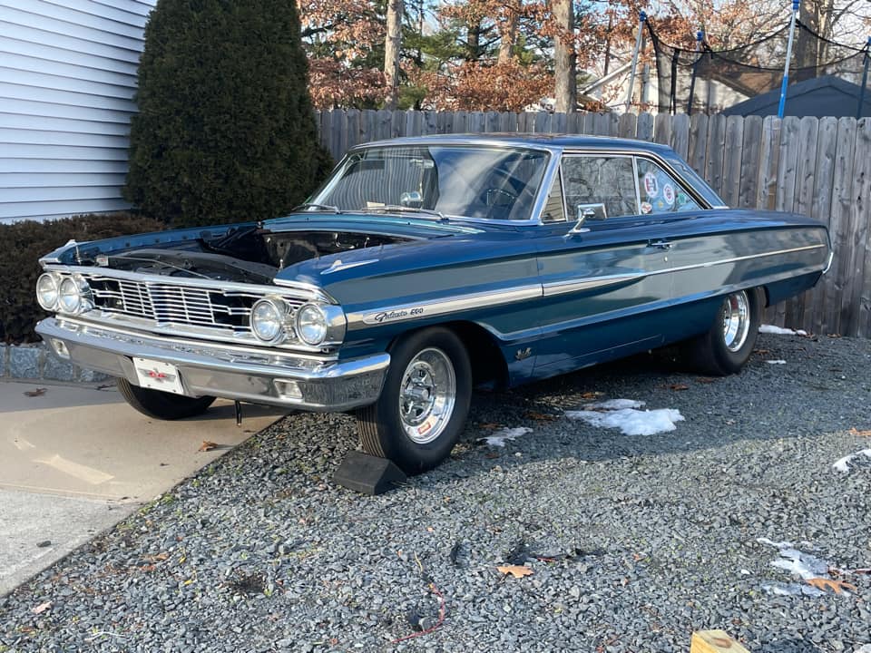

The front Sanders are 9lbs, rears are 11lbs.....and they are 9".....supplied by Larry Hodge.
